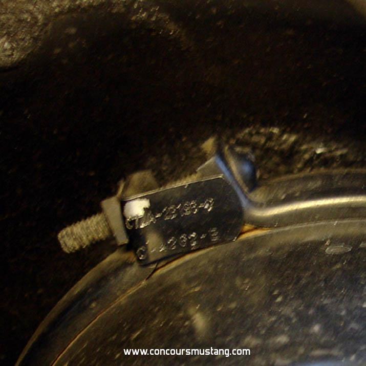

Found a picture of a Midland booster tag in my review of some pictures today. Thought I would share ;)

What? There was writing on the tag? Not mine. The installer couldn't write that small.. I have the supporting evidence.. ;D ;D ;D

The tag material, size & shape, resembles very closely, a shortened engine id tag

The material is a much thinner aluminum then a engine tag by almost a half. It is easily bent.
