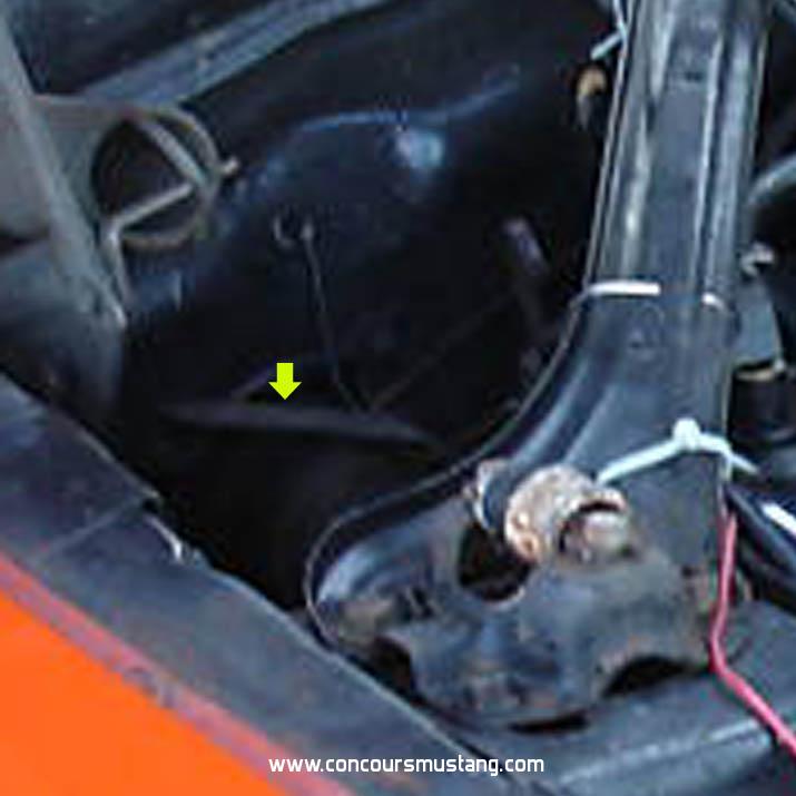

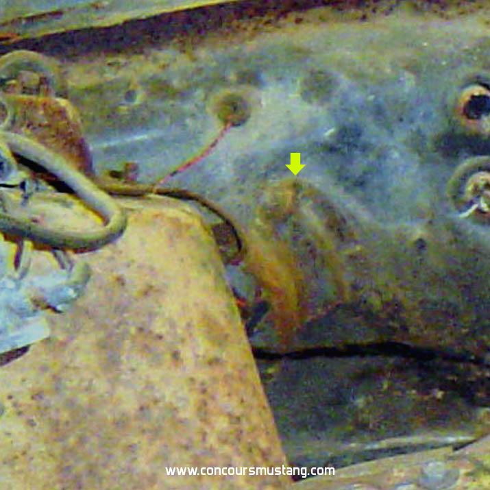

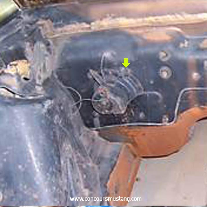

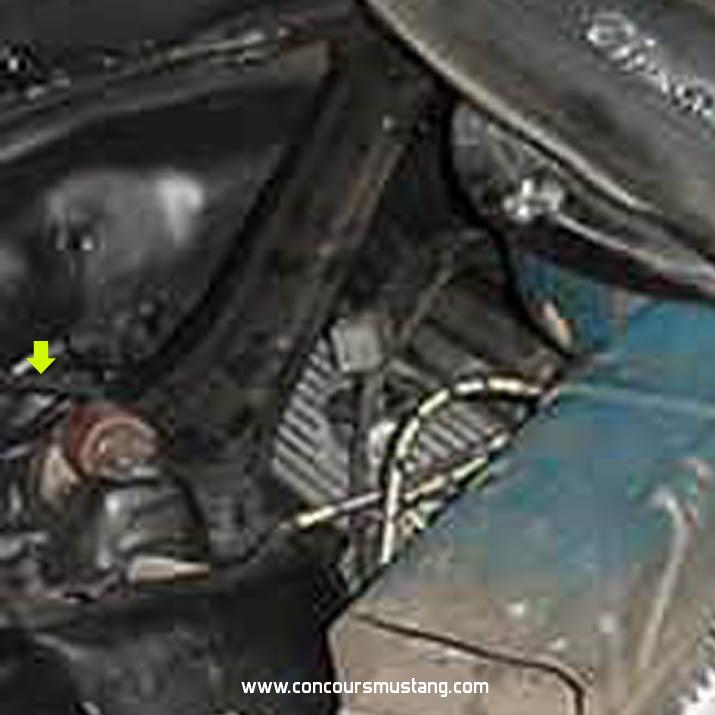

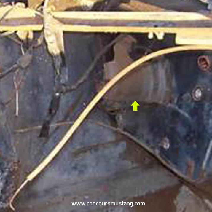

« Reply #26 on: February 17, 2016, 02:44:10 AM »
Jeff, yes I'd like to see pictures of 69-70 non-air cars please. Most of the examples I've seen are for early cars or cars with air.
Here you go - from Dearborn and NJ examples. Sorry some of them are from low resolution pictures owners provided.  In some you can barely make out part of the shield. Did not include any restored cars for obvious reasons.
