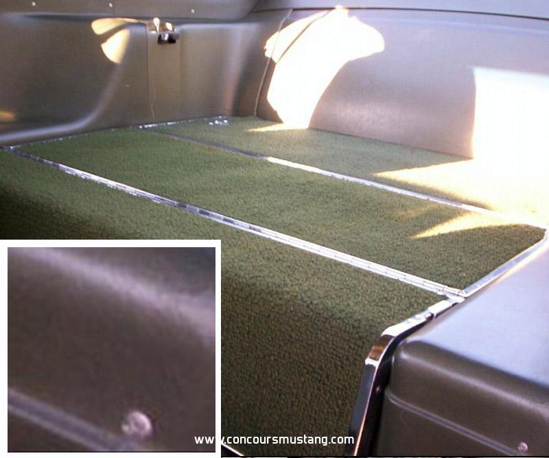

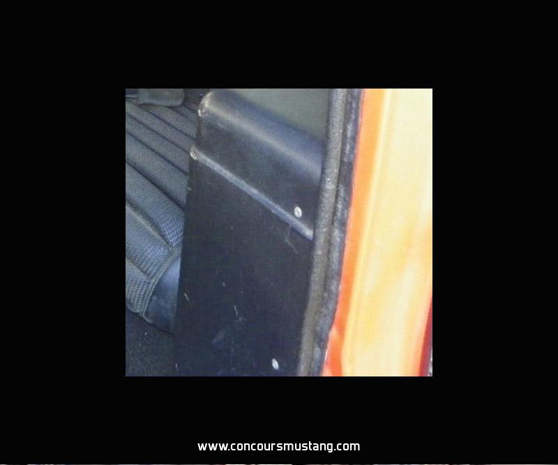

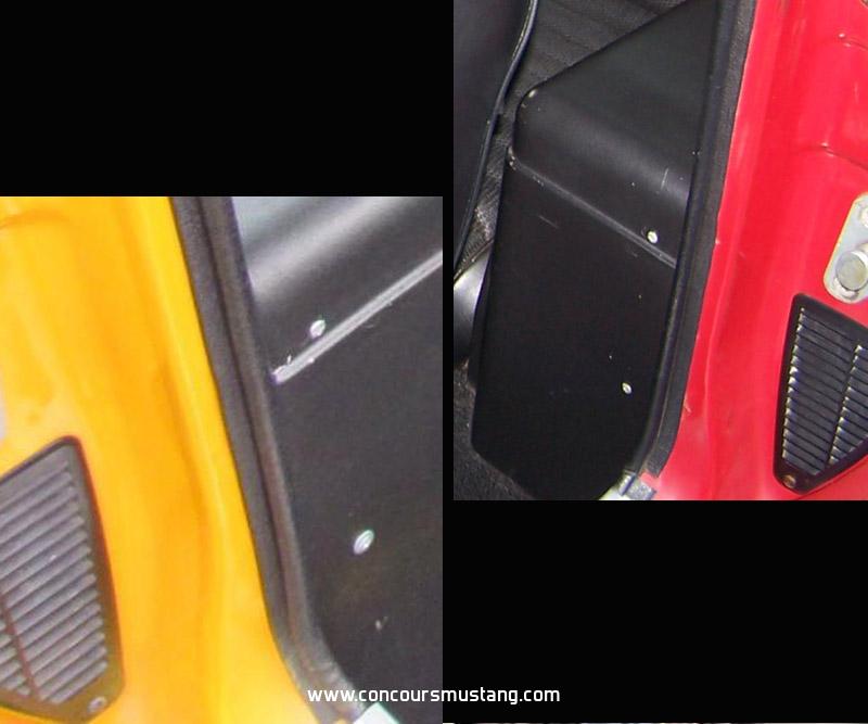

« Reply #21 on: June 23, 2023, 10:33:34 PM »
Thought I would post some examples I found on unrestored cars with back interiors from 70 production. From approx 0F12xxxx-0F19xxxx
Since Hopey brought up Jan 70 green interiors will look and post similar cars to try and help that specific focus. Going to be the same though

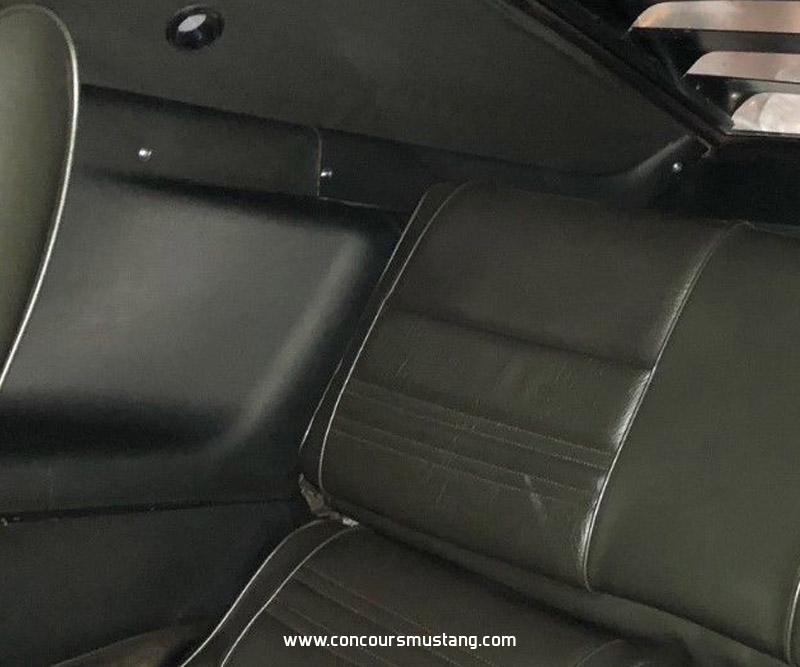

Re: Interior Quarter Trim Screws
« Reply #22 on: June 24, 2023, 12:31:03 AM »
70 Green interior examples. As close as I currently have
Early Dearborn car. Likely built around Mid Sept 69
Nov 17th NJ built car.
