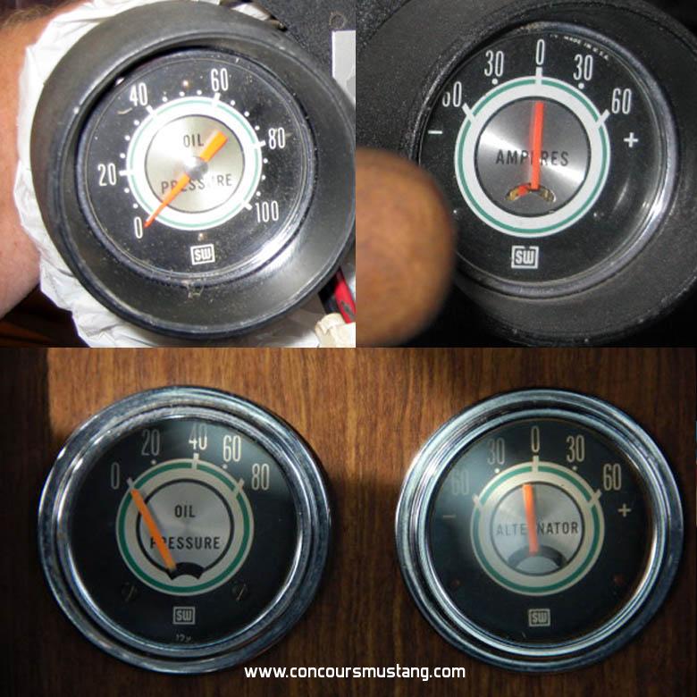

Does anyone know the Stewart Warner #'s for the amp and oil pressure gauges?

67 and 68 or are they different between the years.
Compare ;)

I have an NOS set of SW gauges and they match perfectly to the amp gauge in the upper right and the oil gauge in the lower left.  Ampers gauge is # 357-DP and oil is 352-EJ.   Are the gauges you show 67 or 68 and are the lower ones plain over the counter gauges?
Also the upper picture 67 gauges are a larger size  compared to the 68 smaller gauges.
Since it is one of each then most likely the smaller over the counter version of the 68 gauges. The smaller oil pressure gauge on a 68 is electrical (lower left) and the larger 67 oil pressure gauge is mechanical(upper left). Conclusion they are not assemblyline Shelby gauges.

Thanks, That exactly the info I was looking for.  Its a complete kit # 366-MK with instructions, piping,  chrome bracket, light, etc. I'm seeing what appears to be gauges identical to mine listed on ebay as Shelby gauges.  I was wondering where all these NOS Shelby gauges were coming from.
Rich
Sadly I could spend close to 24 7 emailing all of the Ebay sellers with less then accurate discriptions.
