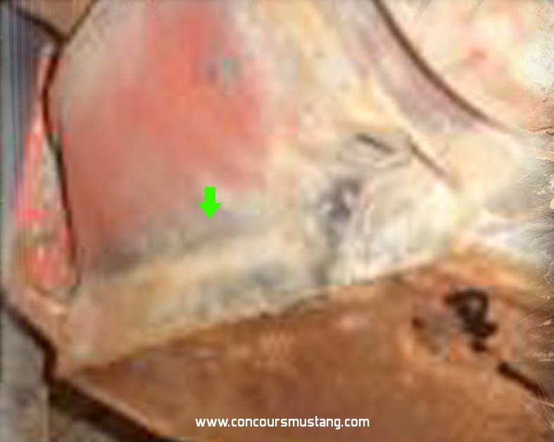

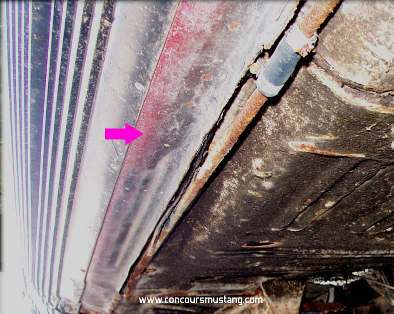

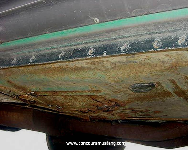

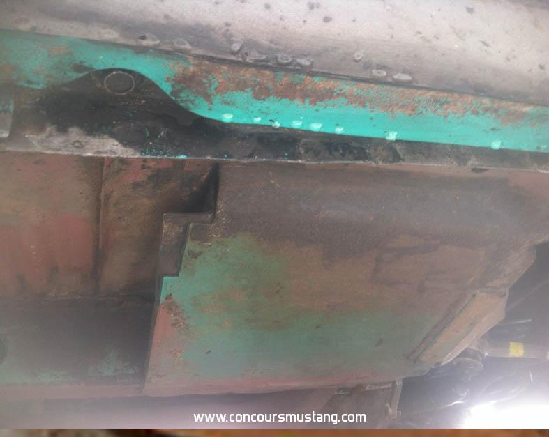

Well here is what I can offer - always wish it was more and the examples were more pristine but unfortunately when it comes to especially NJ cars its a bit tougher to find them.  After looking at the pictures I see my comment above was not exactly correct. The painters did not reach where the molding would overlap as much as I thought it would - just a little short. Guess the angle of the rocker and the cladding kept that area out of view anyway.
Small sampling so they might have gone higher on some examples but from what I've got its only a maybe - not a fact at this point
Hope these help you in with your project
Not a Mach I detail but threw it in to remind those viewing that this was done before the front fenders were installed ;)
A little weak possibly due to the elements, cleaning  ::)  or a repaint
