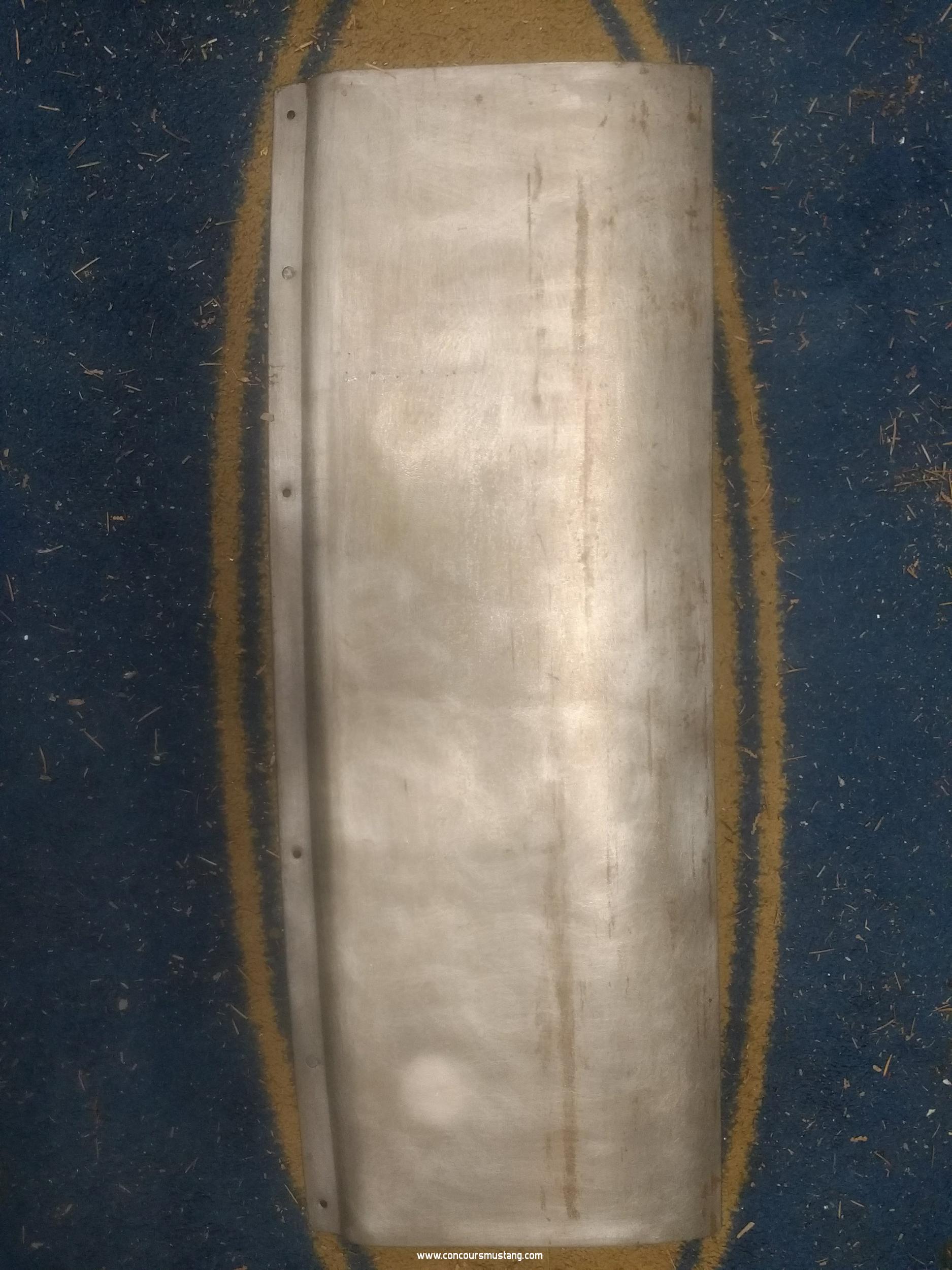

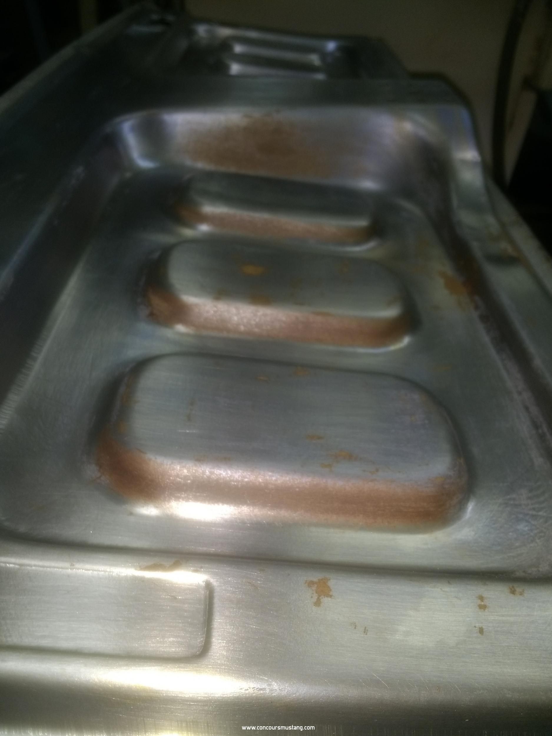

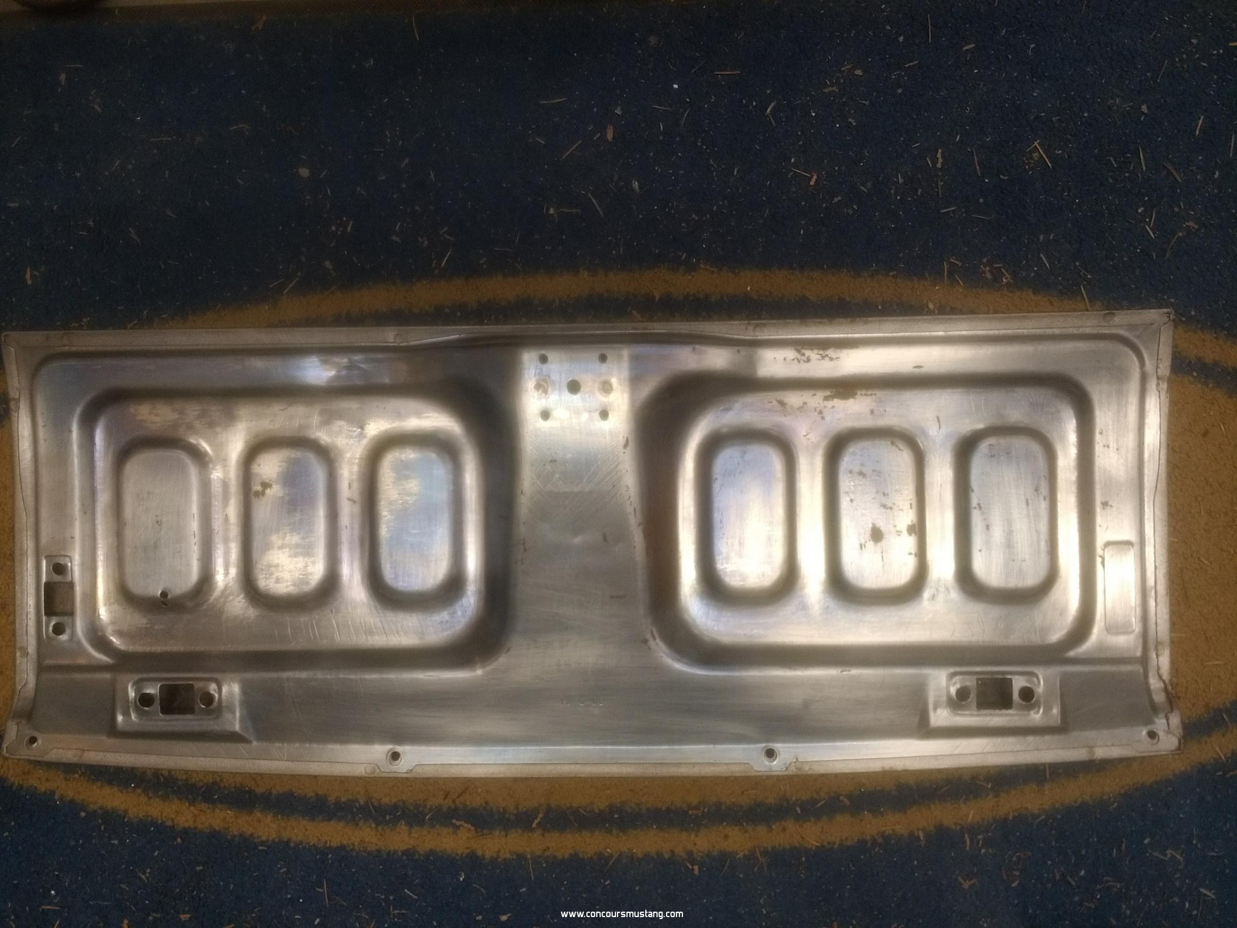

Be sure if you find an old door that you strip it.
I had no idea the back of a stock door appears to be zinc coated. I don't know the year coverage for this treatment but the blueish-silver tinge really stands out. Although coated, the rear has some rust that did not show under the paint. If you don't strip these all the way down you don't really know what's under there.
On the front grain side I also found bands of rust. It wasn't severe but again -- if you don't strip it you won't know what under the paint. The paint looked fine on the outside, but this was lurking underneath.
Added pic
After rust treatment it will be primed first with an etch primer.
