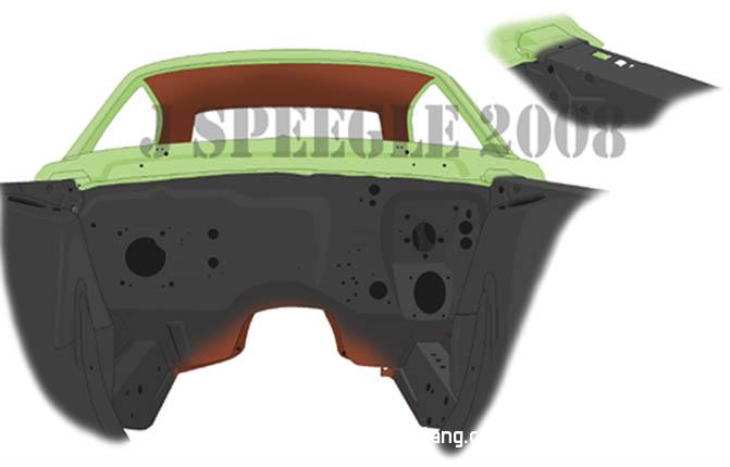

Keith while we're looking at your example you posted and for the benefit for others that might view this thread in the future, the change over point/transision between the engine compartment black and the body color isn't consistent with other original cars and would have required taping off the upper panel by workers.  For others seek out the original unrestored picture threads on this site. Any of the 65-68 San Jose threads will provide examples.
Easy fix with a clean rag and a little additional black paint - good time to  catch it, before allot more gets installed ;)

Jeff, where did I screw up at with the black... I should fix it soon, before the driveline jumps back in..
Where the black goes over the body color along the top of the inner fender panel on both sides. You masked off the whole small short transition panel
Examples of how San Jose painters did it the "edge" is often described as a "soft" edge as if they placed a rag or towel along the edge. Many will backwards mask (softly bending  wide masking tape back over itself or using foam tape to reproduce the edge
Picture A7 in this thread
http://www.concoursmustang.com/forum/index.php?topic=11910.msg71973#msg71973

« Reply #11 on: April 27, 2016, 04:39:01 PM »
Jeff,
Okay, that makes sense. I did indeed mask to the transition.
