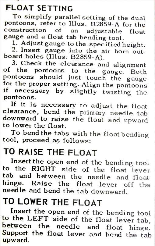

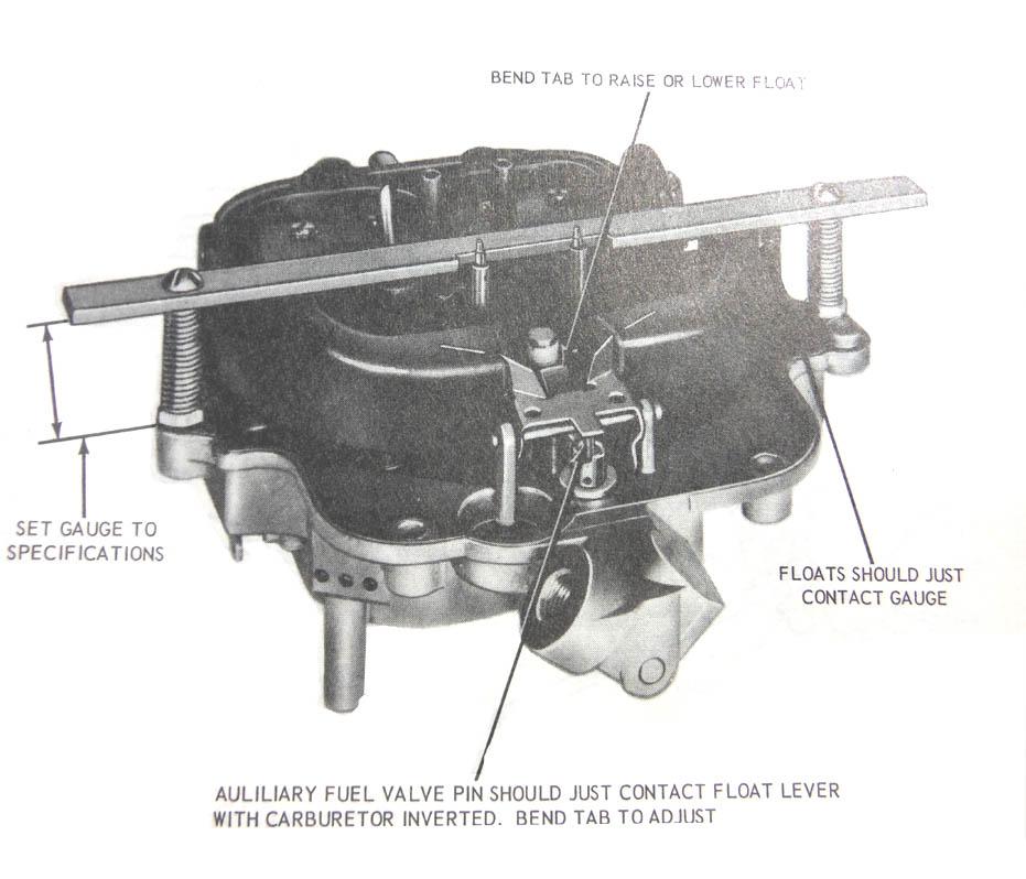

I am trying to reset the float level for my Autolite 4300-d carb. No success so far on the boss forum or internet scouring +++. Could anyone help me with these values? Thanks in advance.

The 4300 requires a simple tool be fabricated to check the level of the "pontoon" type of floats, and most applications are 13/16 in my experience.  Do you have the secondary needle and seat in yours?  If so there are two float levels to set.

To help illustrate how its adjusted (from a 68 TSB article ) Unfortunately don't have the specifications for a 71
