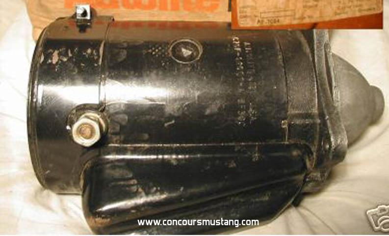

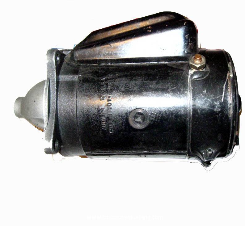

Think we've discussed the paint details in other threads but here are a couple of examples Do have and have seen some where the outer edges of the mating surface to the black is almost bare of any black paint but as we can see not always.

Thanks for the input from both of you. BOB, I think I get what you are saying yet Jeff's images are what I had pictured with my "mind's eye" as I read other threads and is very close to what I tried to reproduce.
If I understand this right, (going on Bob's description) "typically", the overspray, though not masked off, just barely makes it onto the nose cone, not as much as what is seen in Jeff's pictures (again, typically).
It's not impossible for me to remove the paint on just the nose cone (it's a Ditzler Lacquer base, gun-sprayed) but is it really worth it, if I might ask? In person, the transition is somewhat thin, transparent in areas.
