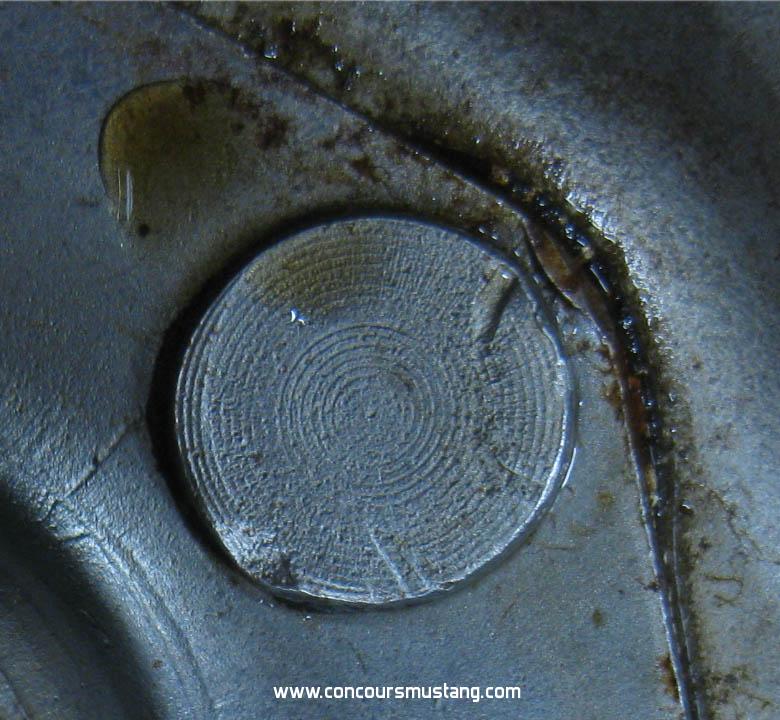

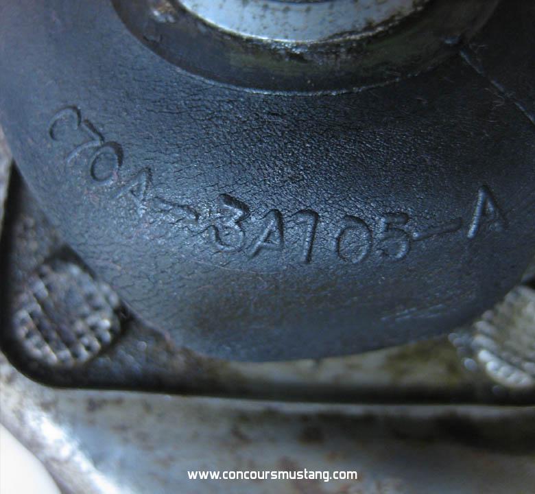

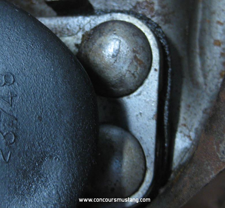

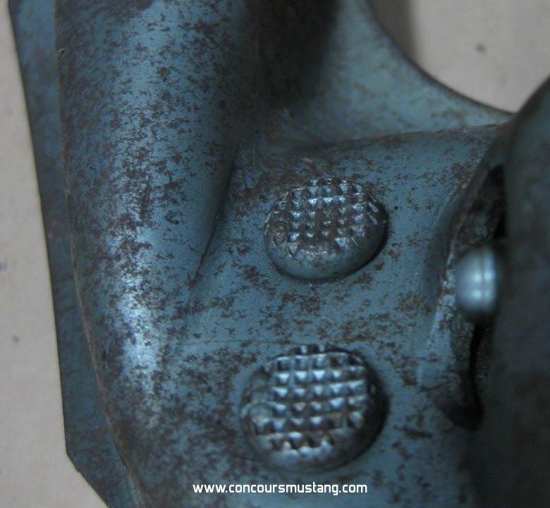

Since it appears that we're making this thread the default Ball joint discussion let me approach this in a different direction
First lets look at some original rivets so that we have something to compare all the restorations and efforts to. After that I'll try and post some pictures of other efforts and you and others can compare
The following are from my April 69 Dearborn example. Unfortunately over the last few years a couple of the boots ripped :( So luckily I shot a few pictures before I had them redone. I know - imagine that ;)
Believe current (in the pictures tone/color of the rivet has changed over the years and through the cleaning process)
Upper A arm rivet - top of rivet
Upper A arm rivet - bottom of rivet
Lower top of rivet
Lower bottom of the rivet
« Last Edit: January 26, 2017, 06:44:32 PM by J_Speegle »
