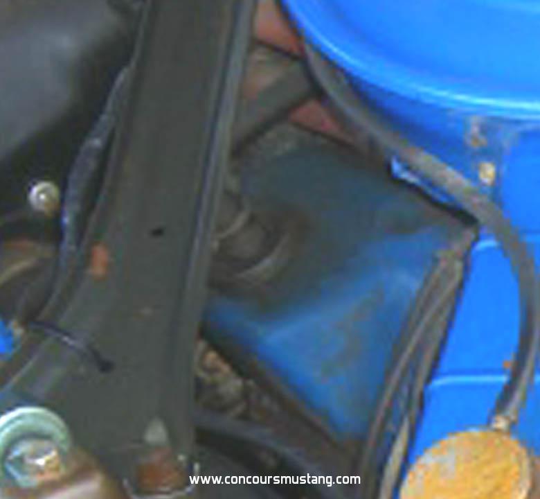

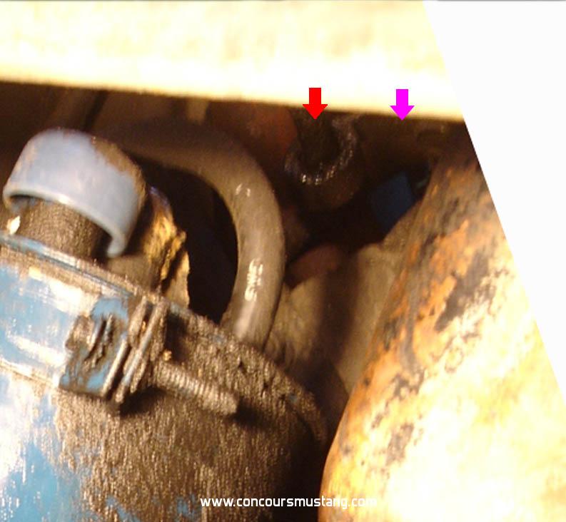

Should the starter cable be between the motor mount & block or exhaust manifold & mount?
Looks like the cable (red arrow) goes over the motor mount and bracket to front top bolt (purple arrow) to you aftermarket starter :( LOL
The motor mounts you have are aftermarket also so no telling what they were designed for or what application they were made for

Thanks for that jeff. Yeah the aftermarket starter was on it when I got the car I may change it back to a clapper starter. Jeff would you have any photos of the right PCV and grommet for the passengers valve cover?

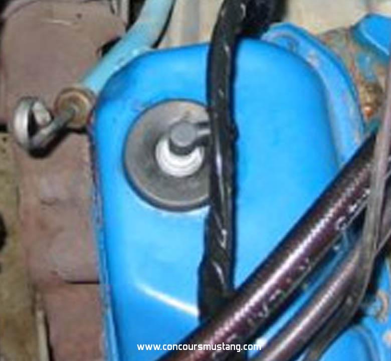

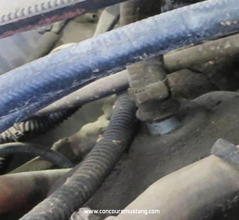

............ would you have any photos of the right PCV and grommet for the passengers valve cover?
Not the greatest pictures (not the focus of the photo original) but hope they help
Thick big round grommet - replacement PCV and hoses
More original iMHO - preshaped/curved hose and appears to be original style PCV

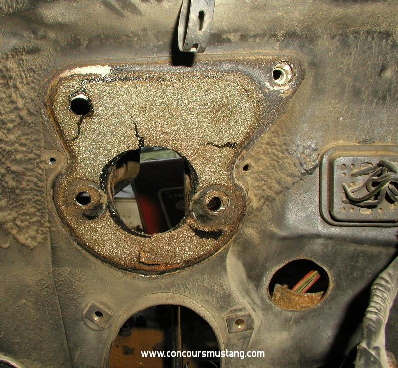

Can anyone tell me what the clutch rod hole in the firewall size is? The car is a factory manual car but the rod seal that you can get for 67 -73 mustangs are to small for the hole. I can not see why the hole would of been made bigger or is it that the seal is really not right for its.

Just for comparison here is another example

FYI don't forget the foam gasket behind the power booster as is illustrated in Jeff's picture. It is commonly forgotten.

Thanks Bob yes I do have a foam gasket when its ready to go back together.
