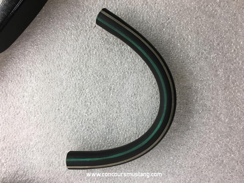

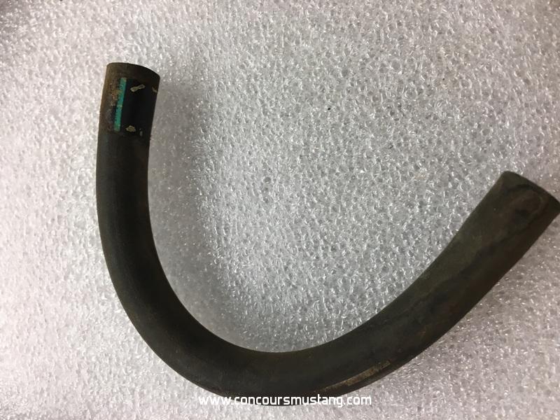

Vacuum hose before cleaning
hose after 45 seconds of light wiping.
Did not affect color stripes.

Respectfully ,there is a difference between cleaning and softening. It has been much easier for me to clean hoses compared to softening .Is the cleaning a by product of the Rubber Renue? i bought a bottle to try.  I have had little luck in softening rubber hoses once they have hardened using a variety of solvents and oils. . If you haven't already tried Westley's Bleche-Wite tire cleaner it has worked well on cleaning (not softening) without taking off markings or stripes. Castrol Super Clean works too but it is a little more aggressive on the markings . Just what I have experienced .Others may have different.

I could not agree more Bob. I was just posting pictures to show what my experience was. Each will have to judge results for themselves. :)
