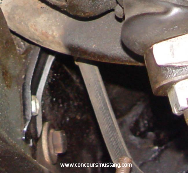

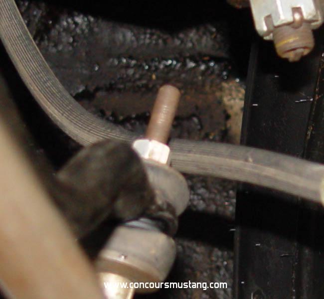

  • Posts: 24232
Re: 64 1/2 Brake Hose Markings
« Reply #14 on: January 13, 2017, 06:16:55 PM »
So back to the forcus
For markings on the front hoses on 65 Dearborn cars I only found one example on a set of original hoses. This example come from one of Mike M's great cars - the other two cars showed no markings on the hoses in the pictures. Those were drum brake cars
This car is 5F08C7275xx and is equipped with factory disc brakes
Two white stripes. Look to be 180 degrees from one another on the hose
