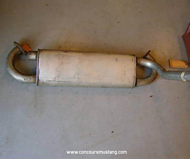

Offline 69cobrajetrugae2
  • Posts: 301
Re: Early Hipo exhaust question
« Reply #14 on: March 13, 2017, 04:50:39 PM »
If it's the axle bump it might be one of these, if not, I'll see the car this week and can document anything you like Charles, Thank you!
