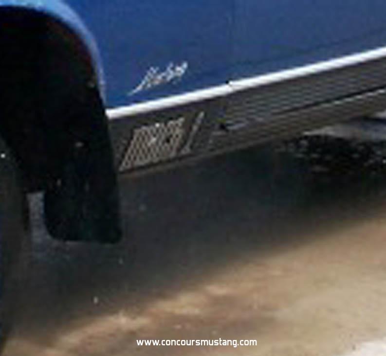

After researching online for just a little bit, I'm still not sure what is correct regarding the front fender "Mustang" script location on a '70 Mach 1.  Mine are high, about 3-1/4" above Mach 1 molding, but most others that I've seen seem much lower.  Is there a right or wrong here?

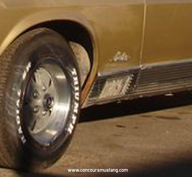

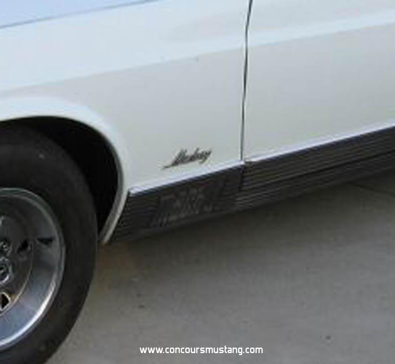

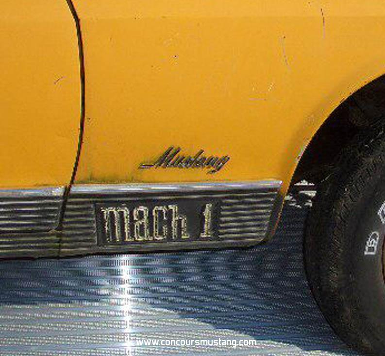

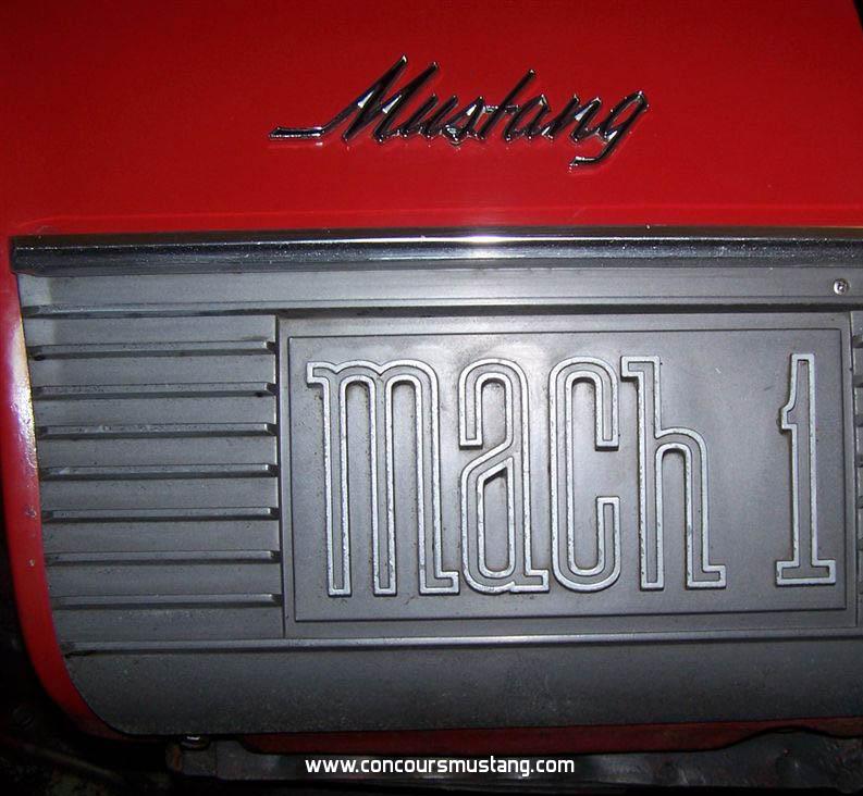

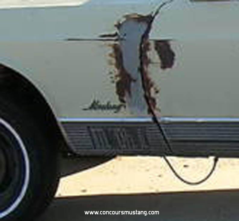

From my Marti report, it's a Dearborn car, built on 4/10/70
So here are 7 examples of what Dearborn was doing around (before and after) your car was built there. All are unrestored examples as usual
0F126xxx
0F144xxx
0F1631xxx
More pictures of that car in this thread - http://www.concoursmustang.com/forum/index.php?topic=10002.msg59330#msg59330
0F176xxx
0F199xxx
0F200xxx
0F121xxx

Thanks for the help.  This looks more "correct" to me as I can't recall seeing other '70s with the script mounted as high as mine
Re: 1970 Mach 1 Mustang script location on fender
« Reply #6 on: March 19, 2017, 01:45:02 AM »
That is what we're here for. They do appear (in the examples) pretty consistent
