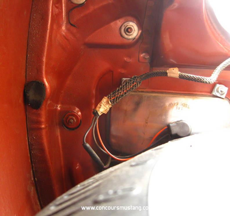

This one my favorite photos (before and after) as we found the SCJ in the junkyard in AZ.  (BLOB OF CAULK)
After
Mark
P.S. I haven't looked at these photos in 7 years!  So lazy I didn't want to take new photo under the cover.

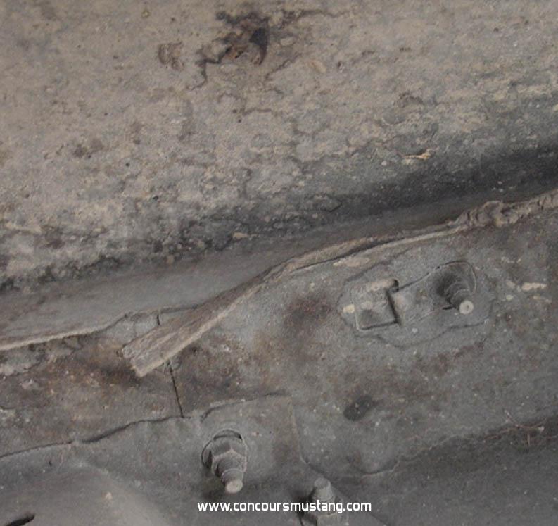

Think the worst example I found was a 69 Deaborn car where about 4-5" of the strip fell off the fender during installation and formed itself to the inner fender panel almost to the bend in the inner edge.

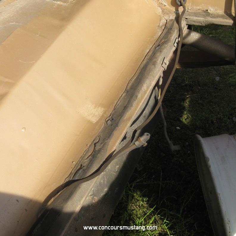

Here are a few examples of the product on 65-66's
As dum-dum to cover the open hole in the rear edge of the quarter panel
To seal the gas tank to body
Strip of sealant that somehow became detached during the installation of the fender.
