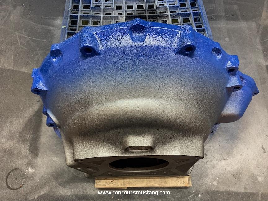

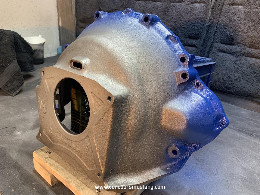

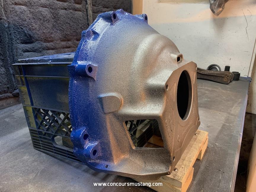

Hi Bob. FYI I painted my bell housing and posted photos in my build thread, but also posting here since we are referencing the subject here as well and might be helpful for others asking the same question. Also curious about the blue & white paint daub marks on the bell housing posted on page one of this thread. I have not seen them before, so not sure if that is applicable to my car.

Good job. It looks most typical.
