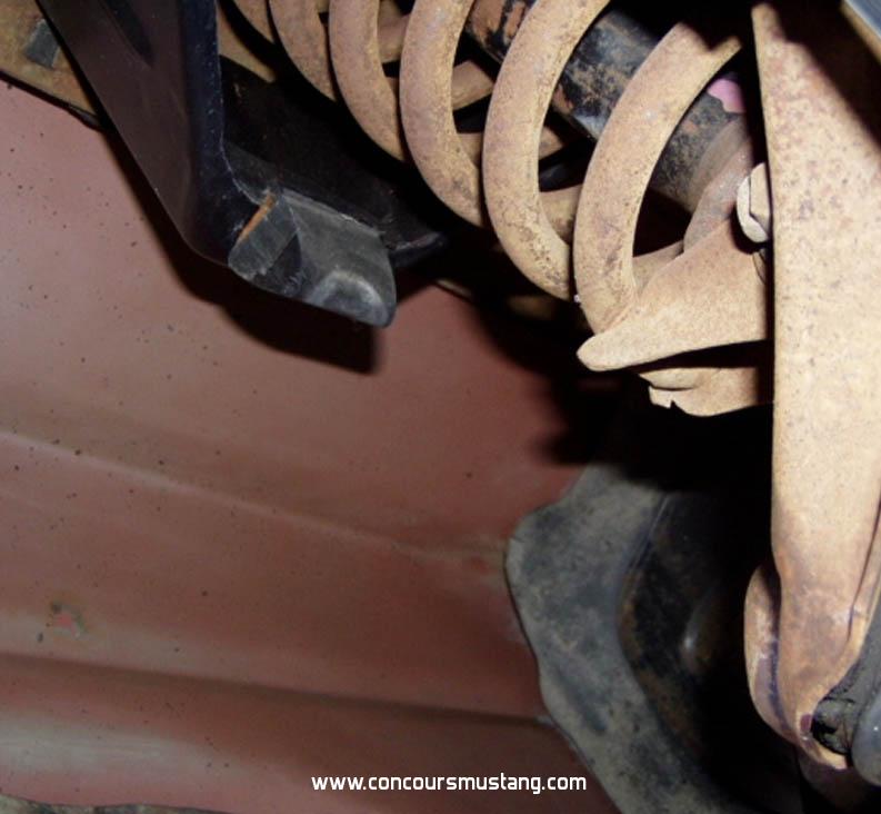

My 11/2/66 built SJ example has a brownish-pink almost salmon colored primer on the undersides of the fenders (I have not stripped them yet) There is NO SIGN of any sound deadener on them at all nor any undercoating of any sort. I could look again around the headlight area to double check for any usage of any sealant, but I think this is fairly accurate. There was no sign of sealant on the rear fender splash shield as found on other examples from other plants and time periods. There is obvious body color over sprayed on top of this primer/sealer at insides of rear fender reinforcement and headlamp area as well as the wheel opening, with overspray lightly reaching the under side of the fender's top due to the wheel opening. I'd say about 60-80% of the under side of the fender you see the primer sealer and the remainder is body color overspray. Scarely any "bare metal" found but any noted would be what was missed by the primer coat and limited to areas like behind the rear welded in fender support since the primer was sprayed (not dipped).

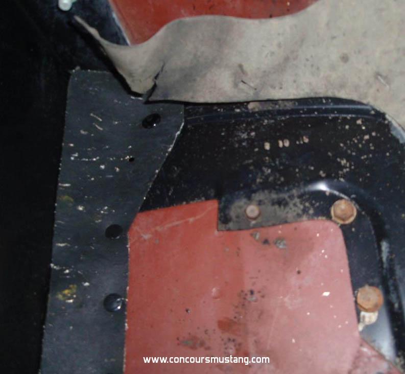

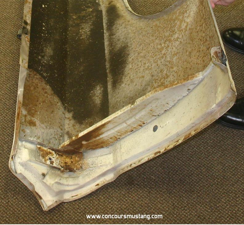

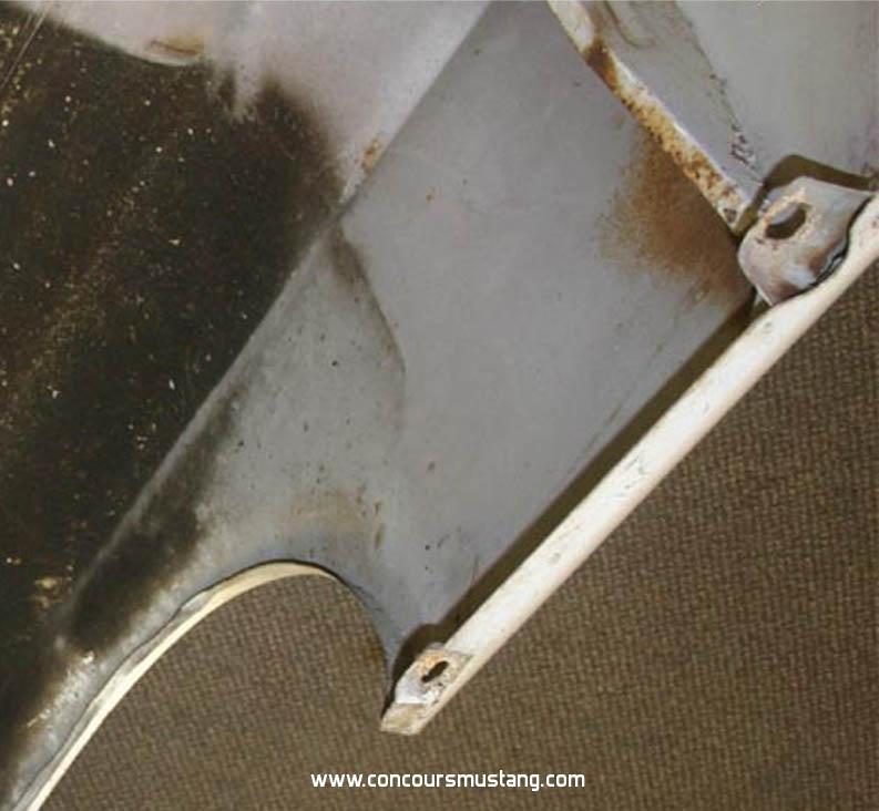

Would not expect to see any bare steel on the back side on an original. Rust may have developed over decades of poor storage and such.
Back sides of the fenders can be (looking at originals) heavy dusting/coat of paint just about everywhere (if the worker for some reason got carried away) or a red oxide with limited body color overspray  and areas of nice exterior color in the logical locations.  What I mean by that is there are exterior surfaces of the fender that were coated and when sprayed would produce direct application of body color on panels directly behind or next those panels. In addition there are areas, such as the back end of the fender that would be visible through the door opening when the door was fully opened, the headlight area, from painting the wheel lip section, area behind the surface where the front valance would be attached.  What you don't want is a spot where you have a nice shinny coat of body color and directly next to or behind, by a couple of inches no overspray. This suggests that your painted taped off the openings and tried to fake the overspray later.  Also the new guns (painters sometimes use small guns for the details) don't apply a nice fog of overspray like the original guns and you can often tell the difference
As for sound deadener I've found about 20-30% of the cars with sound deadener along the back side of the front fenders that was applied at the same time as the inner fender panels. From below in a pit so the under sides of the top of the fender was pretty easy to run the wand along. This pass would often include the inner fender panel lip.

The panels that arrived, like fenders and hoods, already were primered prior to their arrival at the plants so that finish (strong red oxide or a variation) would be dependent on when they were painted at the sheet metal plant and what plant they were made at.
Has nothing to do with the sealer/primer applied to the floor or unibody at each plant.
So an Oct 66 Dearborn front fender might have straight true red oxide, a lighter shade or a darker one. The pictures I posted are not something I would describe as "salmon" in person
