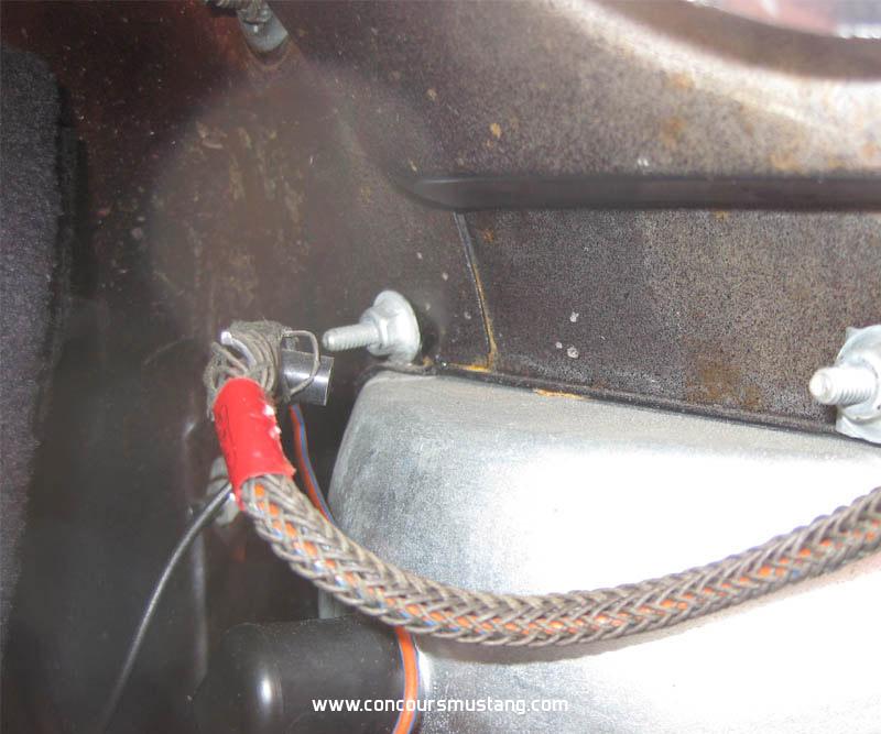

My May 65, San Jose GT Fastback, without backup lights, has a red tape type tag located just to the left of the built-in plastic push on wire retainer that goes to the outer right hand tail light stud. The tag is way to fragile to attempt to remove (I may have gone too far as it is).

« Reply #6 on: April 07, 2017, 08:35:28 PM »
I think my wire tag is orange but will need to confirm when I get back. I don't know if my numbers are readable. I have backup lights.

« Reply #10 on: May 08, 2017, 09:56:12 AM »
I have always seen red on a '65 San Jose fastback without back-up lights.

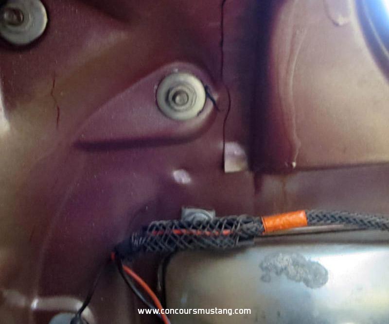

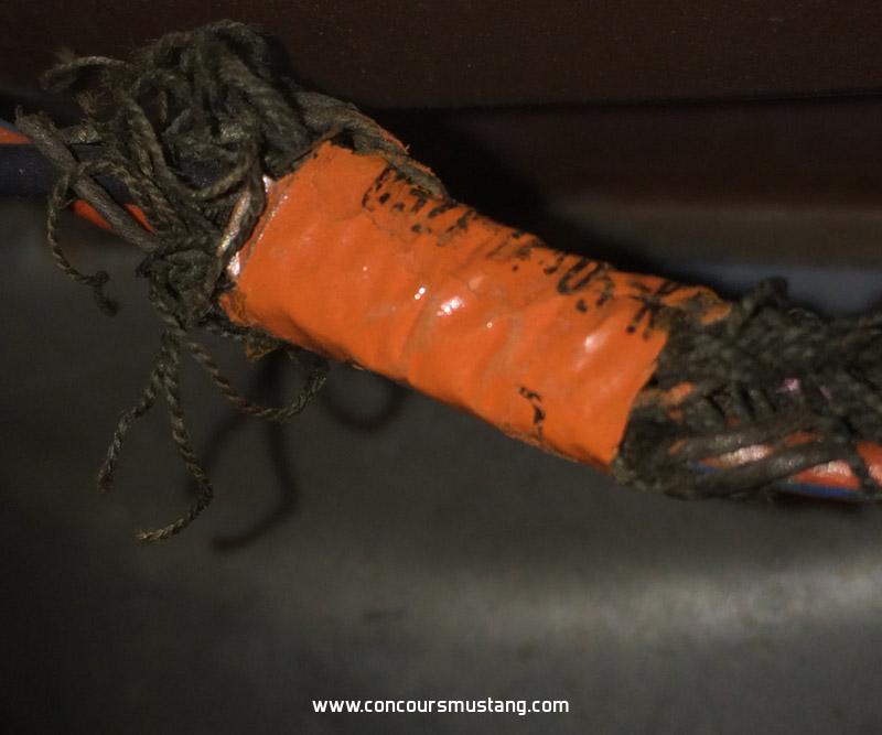

« Reply #12 on: December 15, 2024, 03:59:06 PM »
Marcus recently posted pictures of an unrestored 65 San Jose 6 cylinder fastback that included a close up of the sticker/label being discussed here so reposting them to add to this discussion and collection
Car information - 5R09T149432 - No back up lights
Label C5ZB-14405-K on orange colored material
« Last Edit: December 15, 2024, 04:03:43 PM by J_Speegle »

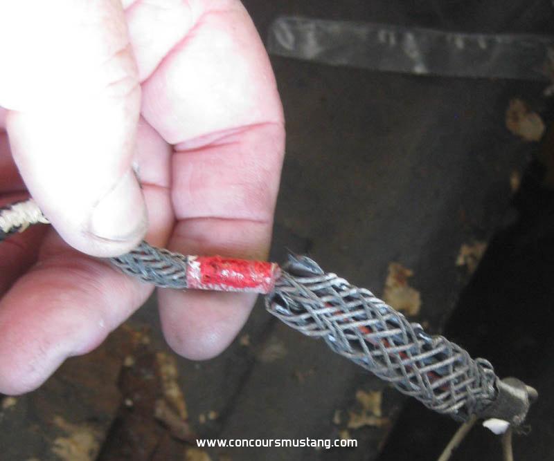

Re: 65 Fastback Wire Loom ID Sticker
« Reply #13 on: December 15, 2024, 04:17:33 PM »
Four additional examples I've collected since the original posting. Can't see the engineering number on each but the color can be used to identify which one/version they likely were. Believe there might be another thread on the subject or at least related since some of these have been posted before
5R09C14xxxx Same as others we've seen built around Oct 64 at San Jose
5R09C15089x
5R09C15468x
5R09C18005xx
Guess I need to look up each example and post if the car had back up or no pack up lights. Will put it on the list  :)
« Reply #14 on: December 15, 2024, 04:32:33 PM »
Yup. That's the same size, same "red" (not orange) color and same part number illegibiltally on my 65.
