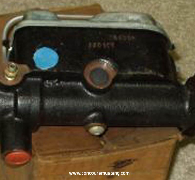

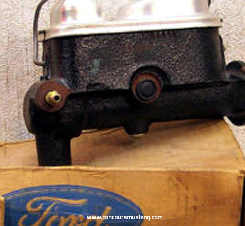

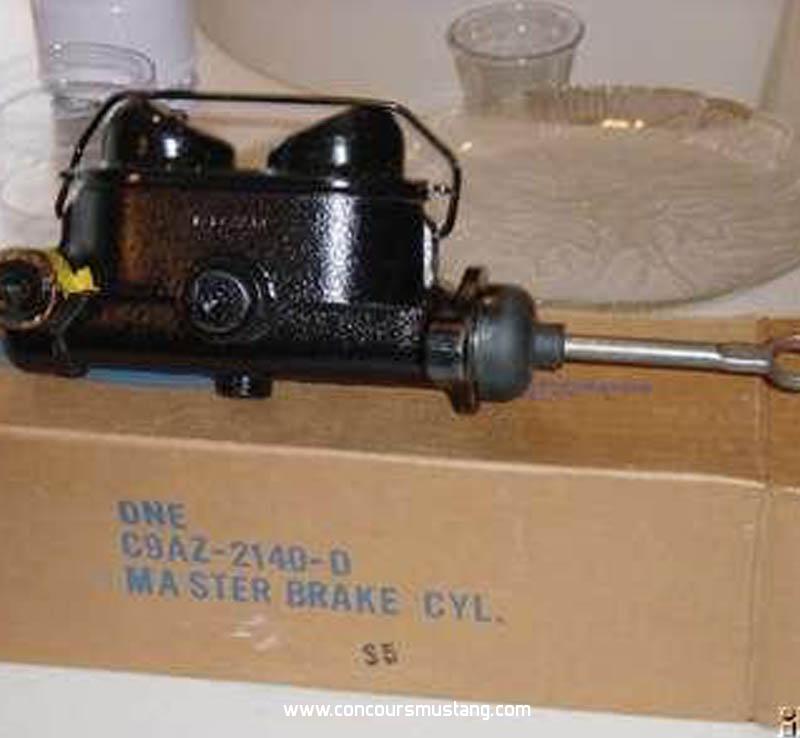

On the subject of the stampings on the driver side of the main body of the master cylinders I have not idea of the purpose or pattern as of yet.
Do have examples of NOS with the stampings for 67-70 applications.  Not all are Mustang examples but they are examples of new Ford parts - not rebuilts. So these are not all 2227161 but they could be used as evidence of a practice from the same suppliers and workers during a time period.
Even though we have this evidence we can't be certain of when they were produced and in turn put into the service replacement pool of parts. If we understood the stampings then we might be able to figure out a date and then when this practice was started.
Not sure if posting the stampings would help. If the consciences is that it would - I will  :)
Couldn't hurt, right?

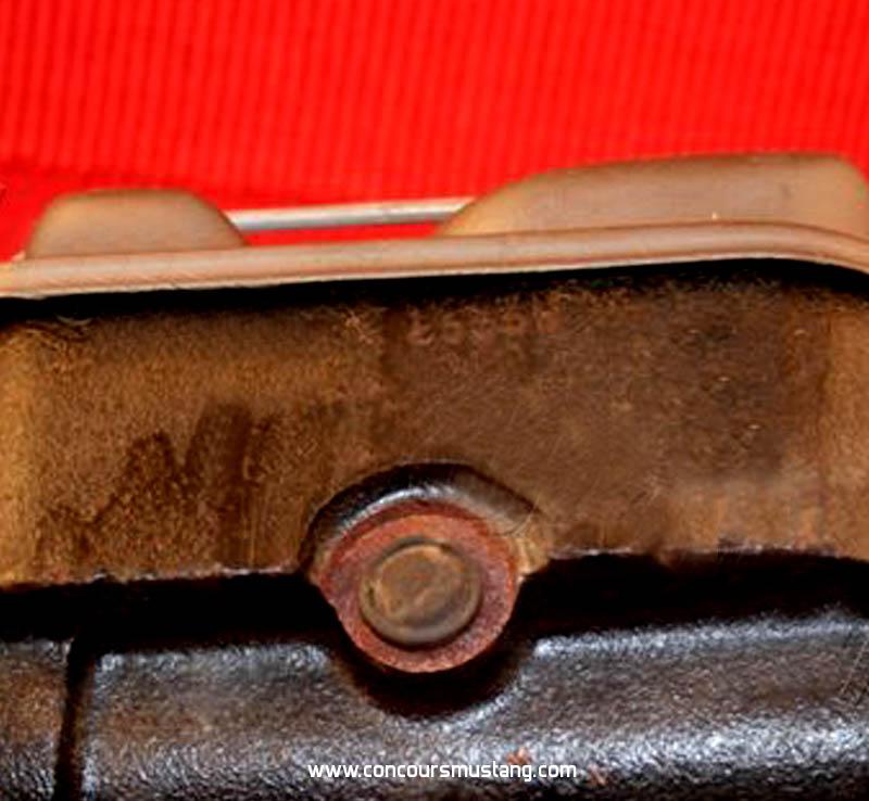

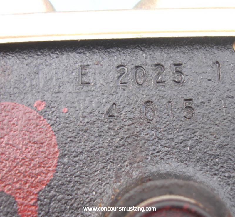

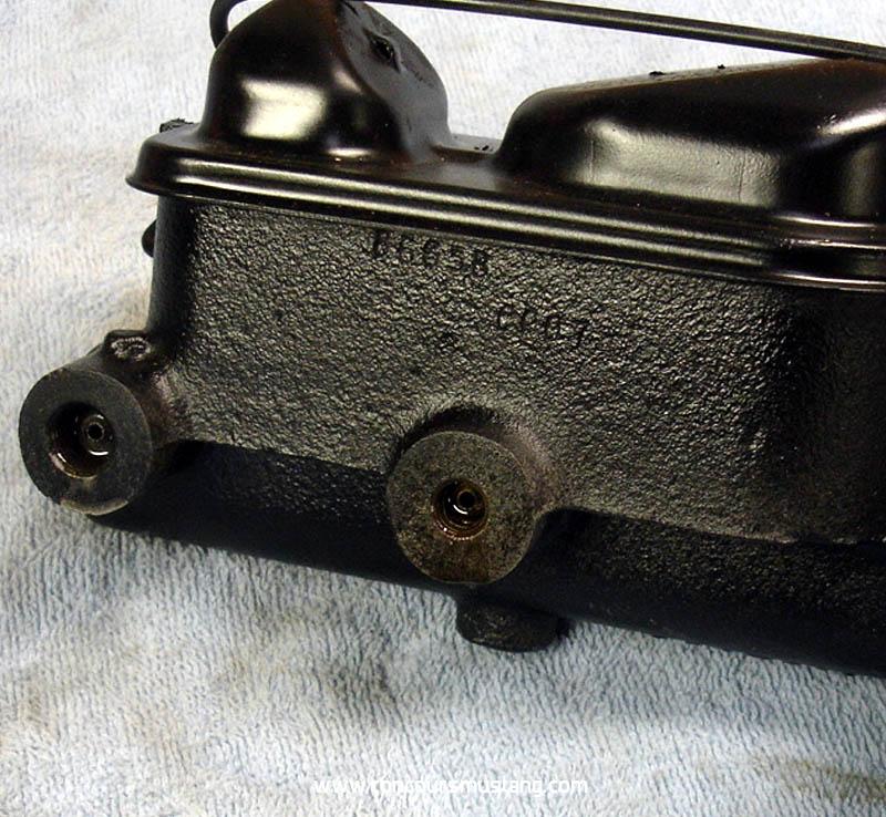

You never know    ::)
Here you go. Though they are not all very clear it appears there were single and two line versions
67  cast - 2227081
C8OZ-2140-A
C8OZ-2140-A
C9AZ-2140-D
C90Z-2140-B
D0AZ-2140-C
D0xxxxxx

I'm in negotiation with this master for the Shelby.  Ok, it's in my hands with a TBD price.
The bottom and sides look right with the correct numbers. Still have to take it apart to check on rebuildability. And yes, it has the cast pimple over the front port.
Two things.
Is this amount of casting flash on the nose normal?
What is the wrench size of the 'small' hex bolt as I will make one on the lathe (any markings on head)?
  • Posts: 9524
Re: 2227161 Master Cylinder Variations
« Reply #20 on: March 26, 2018, 05:02:37 PM »
Two things.
It doesn't appear to have a dimple over the front port .You should be able to see a defined dimple about 1/16 tall and there is none in the picture. From the angle of the picture you should be able to see it if it is there the way it needs to be.  Although the other characteristics are there the dimple is the most visible of them . Yes on some can have more casting flash then others. and Yes some are a easy rebuild (I haven't had that kind of luck) and others have to be sleeved. you can't tell until you open them up. Most need a lot of work just to open them up to see.
Also the most common hex head stop bolt seen on 67's is 3/8 wrench size. There is also a large version.

Thanks Bob.
It does have the dimple but the odd angle and flash obliterated it.
I've attached a pic of it so that others can see it too.
I did have to use some AeroKroil (super penetrant) to get the snap ring out. Also put a lot in all the holes. Let soak.
Punch in the aluminum front piston and turn with sharp edge snap ring pliers so the sharp edges dig into the aluminum internal hole. Popped right out.
The dome bolt required a fair amount of heat from a propane plumbing air torch around the raised edge of the casting. Then it came out.
Interesting nose on the dome screw.
The rear piston stayed in and I didn't want to damage the snap ring area by slamming it down that direction so I took a 1 foot long drill bit and drilled a hole in the aluminum piston. A 5" screw and a small slide hammer got that one out.
The lower portion of the bore is too pitted to use. A guy 20 mi from here does sleeving for $100, so off it goes!

Mine also have faint stampings on the port side that were only visible after some glass media blasting. A fresh coat of paint and these will probably disappear.

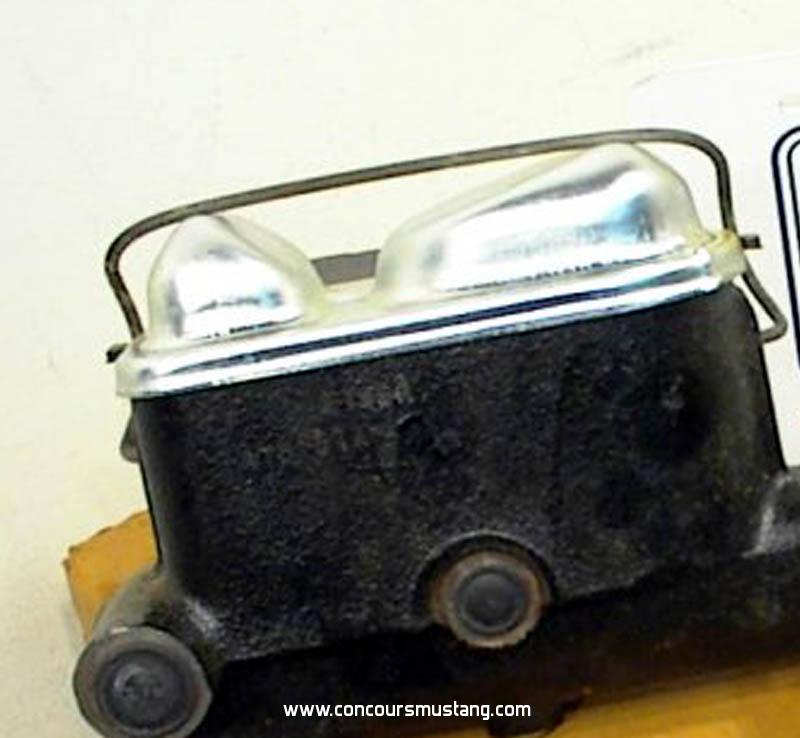

Though not 100% like an original Bendix 2227161, reproductions are on the marketplace that are very accurate in a majority of the basic details. Great alternative, I suppose...while a person waits out an affordable original, which at this time, certain date-stamping codes are not even nailed down yet on. (Referring to the stampings on the sides of the reservoir, nobody seems clear on that just yet so even if you run down what LOOKS right by description: Buyer Beware! One day it might not be "correct" after all!)
NOS units are all but gone or fetch very high prices (as one currently for sale on eBay will likely sell over $350).
USED are also difficult to locate since so many were traded in over the years and most of the time need re-sleeved.
I have an original Used One, it was pitted inside the bore a bit too. I will find out if it needs sleeved after all when I go to bleed the brakes (pitting not where the seals ride on a "full pedal") so in the end, if my original used one "leaks" or "leaks-down", I will probably just replace it with one of these and shelf the other one. I know for sure, I will NOT be paying over $300 for one, not for a basic Coupe application, not considering the current understanding and my current understanding of MCA rules on this item.
PICS attached below
