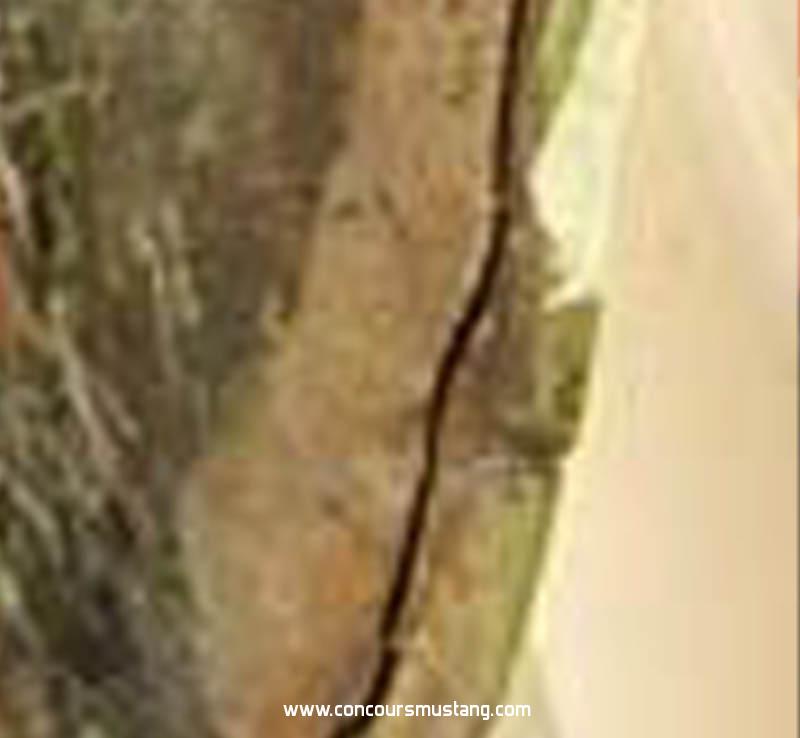

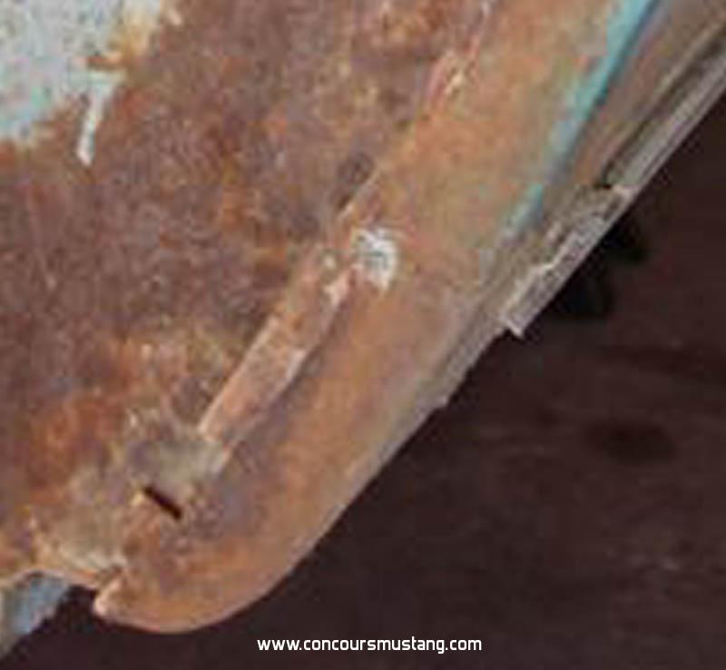

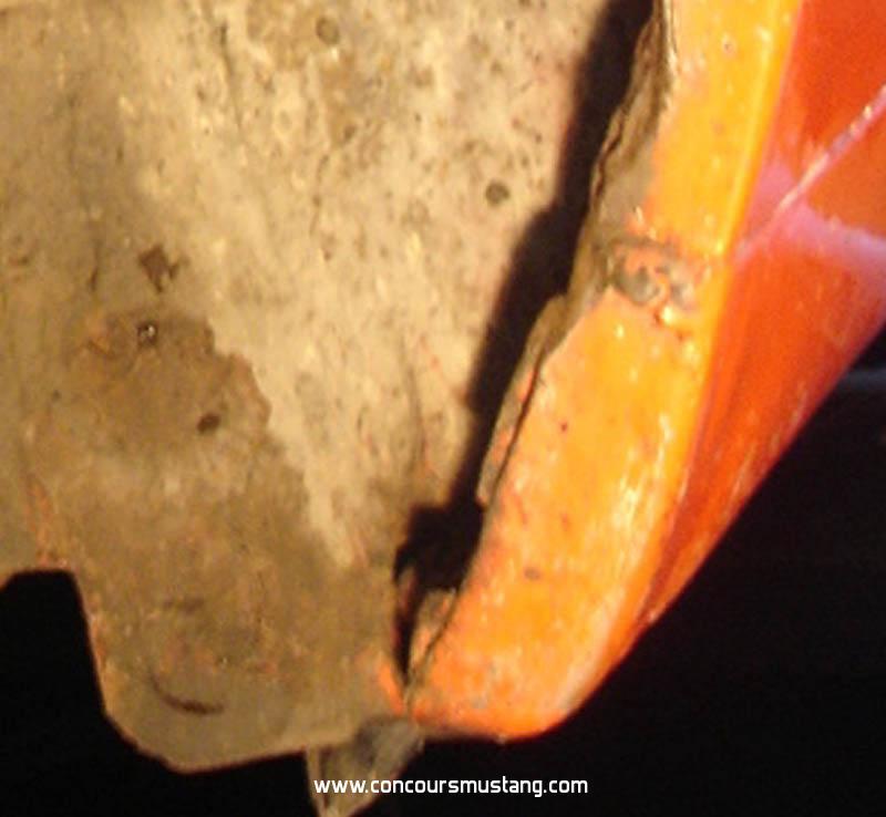

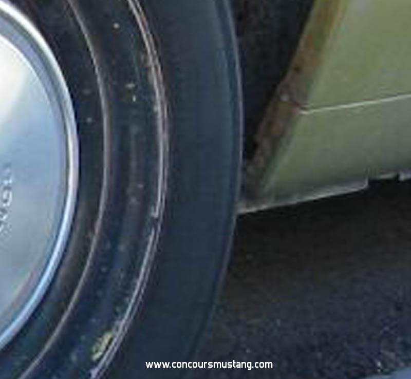

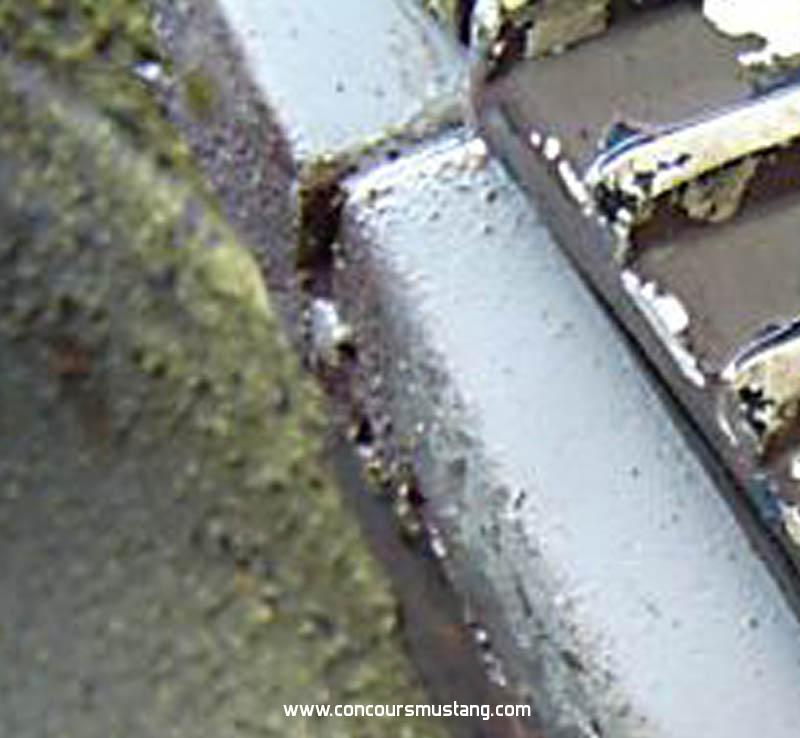

Re: 70 Dearborn rocker meets rear quarter
« Reply #2 on: July 09, 2017, 04:09:30 PM »
If its like other years and plants you should be able to see the seam between the two panels as it rounds the corner and goes into the wheel well to the edge of both panels. You should also see a blob of the brazing that held the panels together at one point before the spot welds were applied Will look to see if I have a close up to post
Thanks for including when and where your car was built ;)
« Last Edit: July 09, 2017, 04:20:32 PM by J_Speegle »
« Reply #3 on: July 09, 2017, 04:42:45 PM »
Here are some examples - sorry for the resolution some were taken from much larger pictures that did not focus on this one detail
Hope these help
