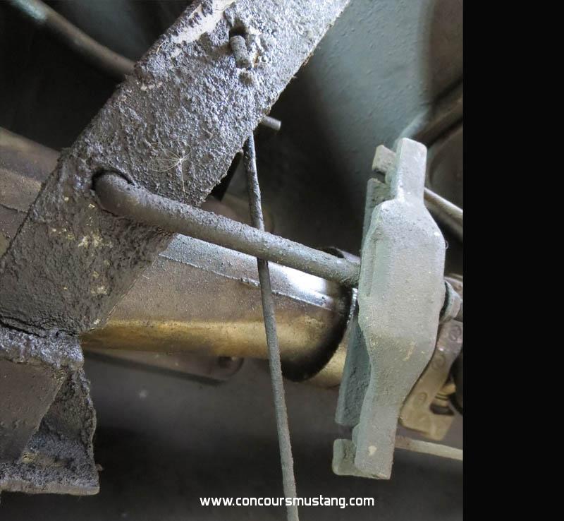

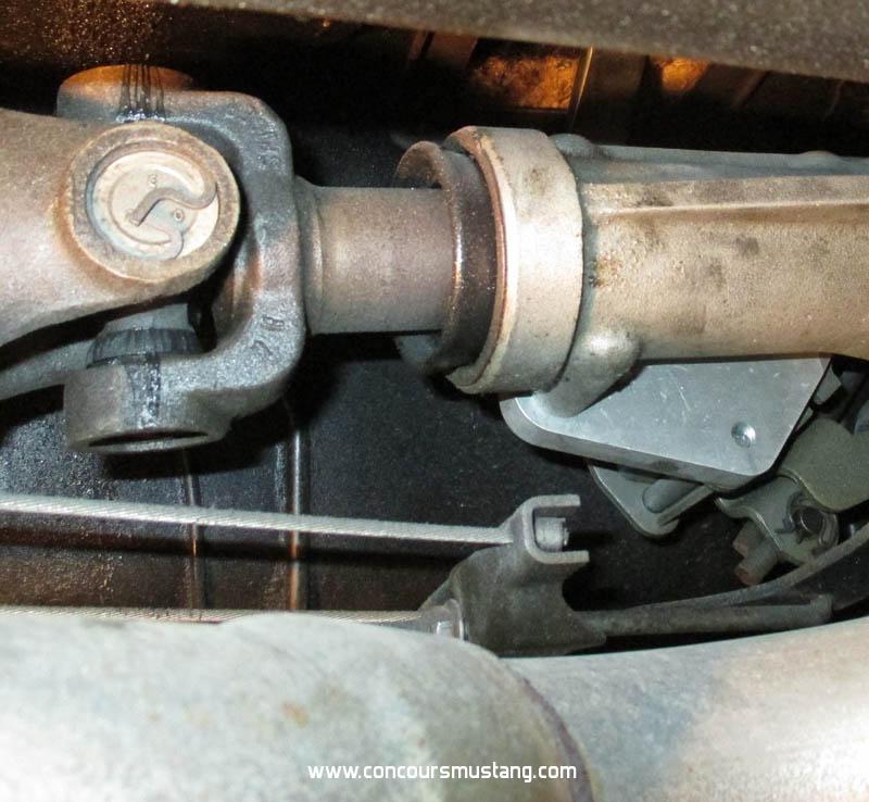

This subject has come up a number of times. My personal hands-on experience has been mostly (for 65) with San Jose cars and I've never found the rod or the equalizer in a dichromate finish. Now with that said most that I come in contact with are fairly dirty or oily. And I think we can all agree that the dichromate part of Zinc dichromate is a weak finish that does not hold up well over time. With that said if they were originally zinc dichrommate we would expect to at least see the remains of the zinc coating since this holds up much better over time
I have always done them as bare steel since that is what I've seen or concluded based on what I saw when cleaning them.
Given the pictures from 65 San Jose cars about I would think the best we could to is compare other parts in those pictures where we agree the finishes are than compare those to the parts in question.
I have seen Mikes examples and have additional pictures of 65 Dearborn that appear to be zinc dichromate
Not sure if this may be a different supplier detail or something else at this point in time - but that is why there is a discusion :)

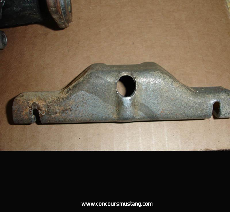

BTW I believe the picture of just the equalizer above that I posted is from one of your SJ cars
Yes, I recognized it, but not a good reference of what I was seeing.  I was so confident I had seen it across all the plants that I stopped looking and automatically put the parts in the zinc dichromate pile for re-plating.
As for the zinc plating underneath, it just depends what environment/conditions the parts are exposed to.  Usually if the gold is gone, the zinc base has started to break down also.

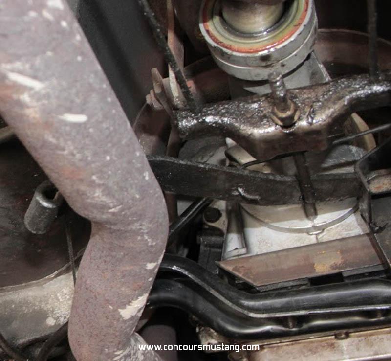

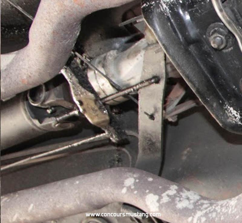

I don't know if these help or not. This is on an Oct 64 SJ car.  Did the best I could right now to clean up the area but the car isn't jacked up and it is a little toasty in the garage.

In your pictures - without a good wipe down the threaded shaft, adjusting nut and equalizer all appear to have the same look

Mineral spirits with a soft brush would be best to clean with as it normally won't remove any plating.
From your pics, the equalizer bracket shows signs of dichromate plating.
