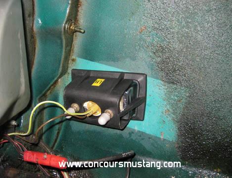

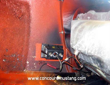

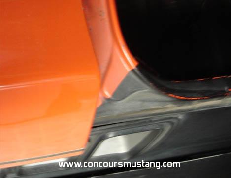

Rectangle masks over the side rear marker lights so that black overspray did not exit the trunk and get on the exterior.

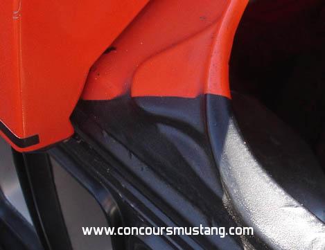

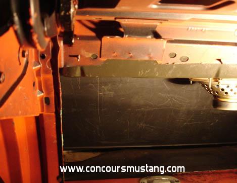

Masking across the taillight panel at the fuel filler opening and taillights to again keep black in the trunk compartment. Notice the differences of how far downward and forward the black was applied across or not across the rear cross member and trunk sided floors

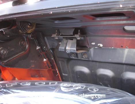

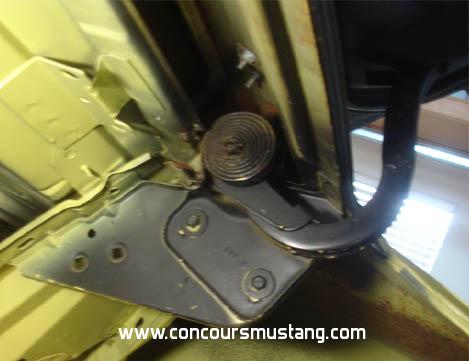

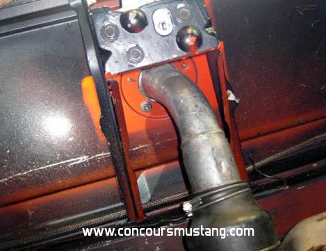

Black out of the trunk lid hinges and the amount (again a little or much more) of black forward and under the trunk forward panels

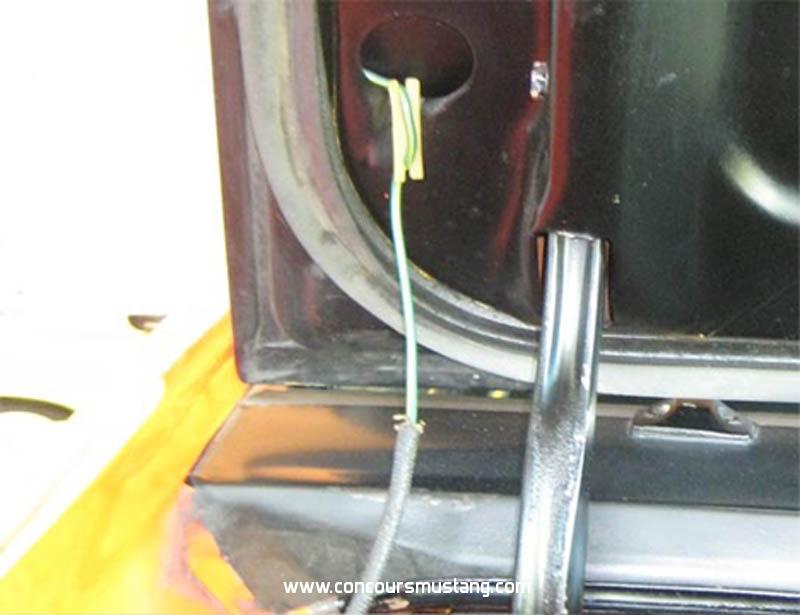

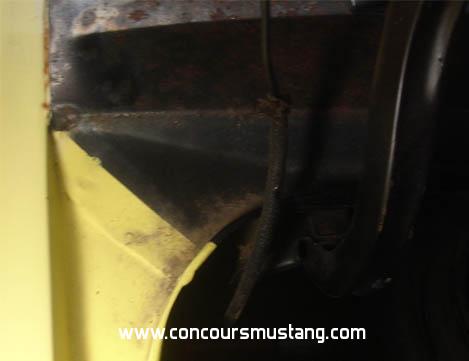

Examples of the masking for the trunk opening corners. Notice the quick masking often produced gaps between the maskign tape and metal allowing small blow-outs at the compound curves since the workers did not take the time to press and shape the tape to the panel features
