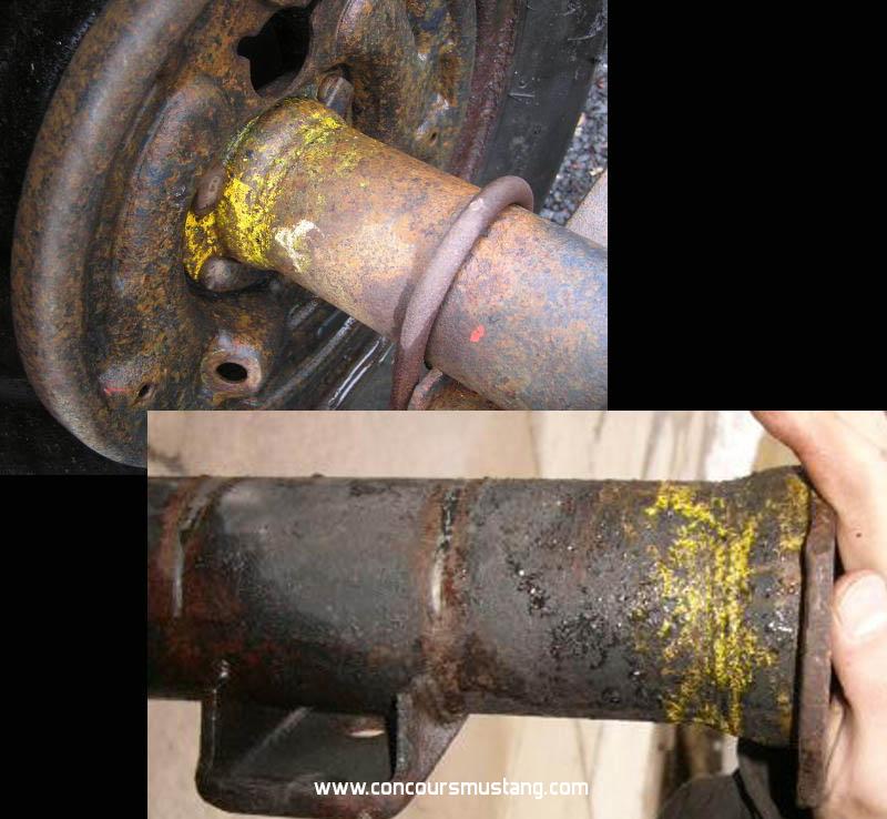

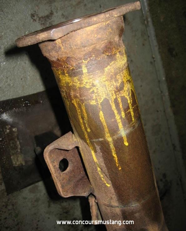

Re: 1970 rear axle housing yellow paint
« Reply #9 on: December 05, 2017, 02:49:17 PM »
Here are a couple of examples. Most of them I've seen or found appear to have been applied when the rearend was level (as installed) or on end with the paint applied to the end on the down side. But then there are examples where it appears the were applied on the top end of the housing while standing/held with the other end downward. Or could just be the results of using or or less paint on the brush when it was applied.
« Reply #10 on: December 06, 2017, 11:48:35 AM »
The 69 Dearborn gt500 Shelby  we had in shop last month was exactly like jeffs last pic with the yellow runs on the rh side & it was june built.

« Reply #11 on: December 08, 2017, 11:29:52 PM »
Lots of great comments guys thanks, Jeff, I will proceed with yellow painting the passenger side as planned. I can't really tell the extent of the yellow paint as the original housing was quit rusty, so think I should paint with the housing standing on that end and do some of the flange and about 1.5" of the housing tube, much like Bob did on the Boss 429 housing.
