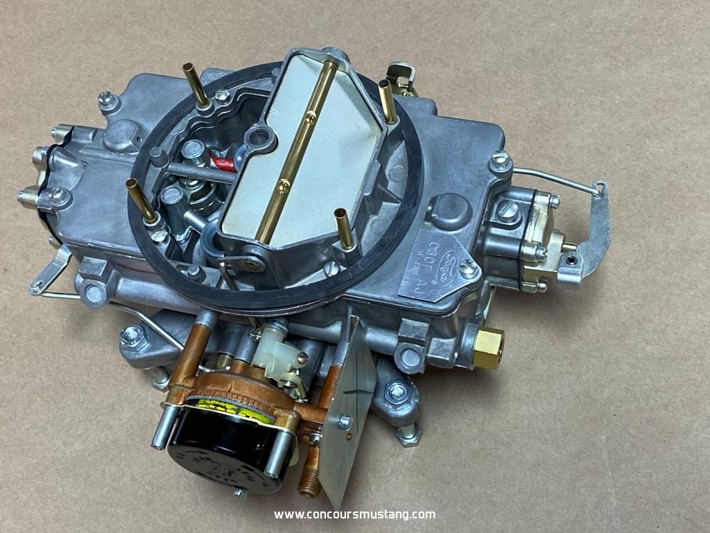

A C3OF-AJ A 4AB assembly I just completed here in January 2022.  Headed for a highly detailed original Cobra's restoration.

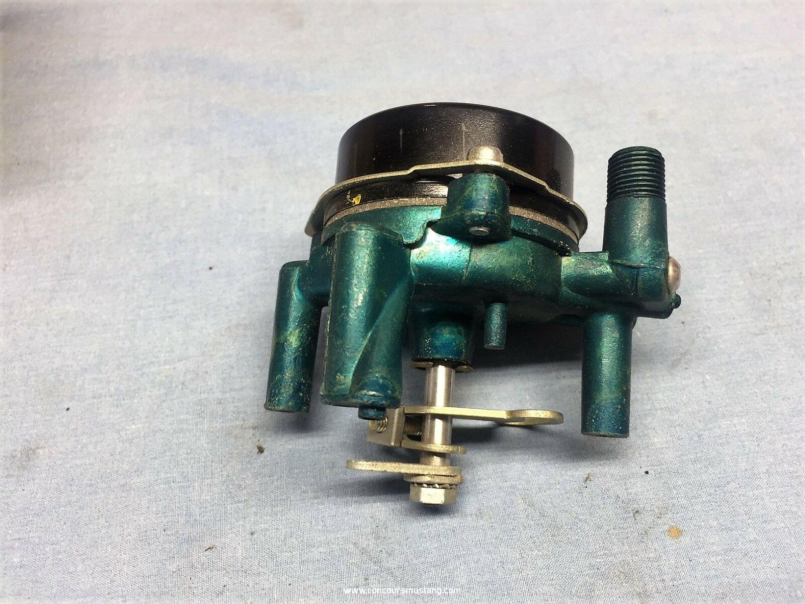

Dan, what is the finish on the choke housing called ?
Offline Dan Case
  • Posts: 200
Re: Autolite 4100 Restorations
« Reply #23 on: January 15, 2022, 07:44:50 PM »
The manufacturer, Ford or their supplier, used some kind of very thin paint over the dichromated zinc die casting. Painted castings were submersed such that every surface was painted inside and out. Some organic chemical solvents and other harsh chemicals will wash the paint off. The reddish copper (light bronze?) color seen was called red in period Ford Master Parts Catalogs.  Ford had several different 2100/4100 carburetor choke mechanisms in the 1960s identified partially by their main body casting's color code. I have a new old stock 2100 (2V) carburetor with the plain color (just the dichromated zinc casting) choke mechanism body, a new old stock 4100 (4V) with a bright blue paint coat on the choke mechanism body, and a new old stock C3OF-AJ (4V) like above with a bronze paint identification.
Not my listing but here is a blue 1960-61 version.
Listed is a NOS 1960 FORD CHOKE HOUSING. Ford Part #C0AE-9850-E, Autolite #CC-18. Should be correct for 1960-61 Ford Galaxie, maybe other years/models.
