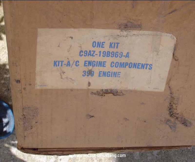

On the AC parts and pieces I will do some more research on that.  I have to say its not common to get a Cobra Jet engine with AC, but they are not that unusual either so will dig a bit more into that and maybe do a separate piece on that subject.
Great effort and as mentioned a lot of work
Do have a NOS AC parts kit (engine bay kit) for a 390 boxed in 69 if you want to use some details from that.  Many of the parts would have been the same while a couple of the items included would be different from assembly line but depends on how far you go as far as parts covered in the article. Easy to start chancing down rabbit holes

Well....chasing down rabbit holes is what we do.  Have to dig into the details to find answers.
I would be willing to work on something that outlines the AC parts and pieces.  Send me a message and we can get together on that if you want.  That would be a great start with what you have there.
