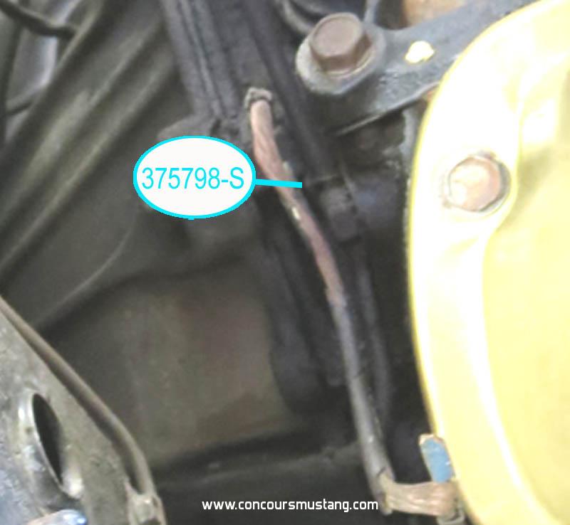

Lets try this again since I posted first a 66 example  :(
Sorry guys its a tough spot to get a picture and when I took it the purpose was just to get an over all picture of the area. Chris this is the same example I've been using for your car int he past since its so clost to your car.  In any case- can barely make out the edges of the clip but its there.

So some what of a side question, because I can't tell from Bob's picture he posted, does the ground strap attach to the same bolt as the J clip or as the transmission filler tube?  Or are all three on the same bolt?

Chris : The Illustration I posted does not show the Ground Strap ; however, the picture that Jeff Posted just before your Reply does appear to show it being attached to the head at a different location than the clip, very possibly along with the AT Dipstick Bracket. Note that in the Illustration I attached, it does show another bolt (albeit the same hardware Part Number). Typically if it were the same bolt, the thin line showing where it goes would come from the bolt, then thru the clip and then thru the Dipstick Bracket. Since it does not appear to show this, I would say that it is not the same bolt being used.
Maybe this attachment will show the separation a little better.

On my "relatively untouched", Oct 65, San Jose Fastback, the ground wire and transmission dip stick tube share a bolt. What the part number is will have to wait (either 42772-S8 or 20312-S36). There are three 3/8-16 tapped holes on that end of the head (the RH rear - see the LH head front for a visual representation of what I'm referring to), two are at the top and bottom of a 1 5/8 - 1 3/4 inch plug used to cover a casting (?) hole and a third closer to the center line of the engine and higher up on the head. That third one holds the 375798-S clip. The upper tapped hole of the first two around the plug, holds the shared ground wire and tube. (A MT car would have the ground wire on that upper tapped hole.)
(On a LH head, the tapped holes are used for power steering and/or A/C pumps.)

Is there also a toothed washer for the ground strap as well on that bolt? Looks like one on Jeff's picture.

There should be one on the firewall end and the other on the engine block side . The toothed washer is supposed to be the first thing that makes contact so as to dig into the surface for a more positive ground.
