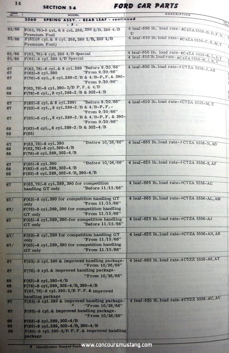

Went back and cross referenced  known cars, paint markings, spring numbers and the MPC and I can see where this got a bit jumbled for me.
Here is a picture of a page from April 68 MPC. You will notice that the ordered that the info is presented is standard, for competition handling GT only then & improved handling only. Its interesting that the and sign was inserted between the engine size and the suspension description in the improved section but not in the other two.  This difference in order may have added to my confusion.
Now to confirm the applications I took spring numbers from know cars (taking into consideration options and accessories) and they seem to match in all but a couple of examples. Apparently one set of data may have come from a comp suspension car that I and the owner did not realize.  Seems a bit strange to have located a fair number of these very rare cars.
There are a couple of springs used in 67 production that are not included in any of the MPC's  and there is no mention of the substitution or replacement but realize that the real guide to this is a separate/book book that shows casting numbers and conversion (new) part number that was published often. Right now can't find anything that shows application for C7AZ-Y and C7AZ-AY
Another thing that added a twist is export cars with the improved or standard suspension parts.
So as right now my understanding that for this exercise and for rear springs
"improved" equals GT and GTA application in 67
while & competition handling GT  equals Shelby's and cars ordered with competition suspension.
Here is a picture of the April 68 page for rear springs
So in an attempt to find an answer to your first question would you agree that your car likely/possibly came equipped with rear springs marked C7ZA-5556-AU or AV?
Believe the "C7ZZ" is just a typo
So, (Re: Rear Springs), can we assume that "Improved Handling" springs should be found on ALL GT's & GTA"s?
