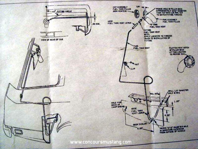

Anyway ... just looking for PICTURES of how the tube routed, where and how the filler neck was modified, and where the hole in the trunk drop-off was drilled so the hose could stick out of it.
If a copy of the RECALL itself exists and/or instructions of how it got installed that would be VALUABLE info as well.

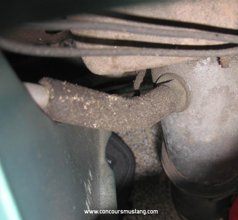

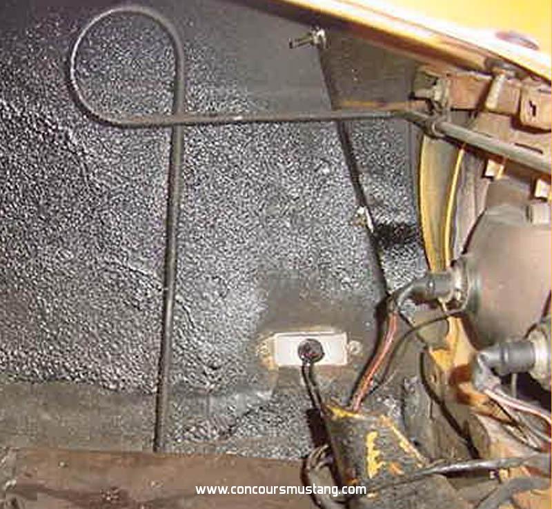

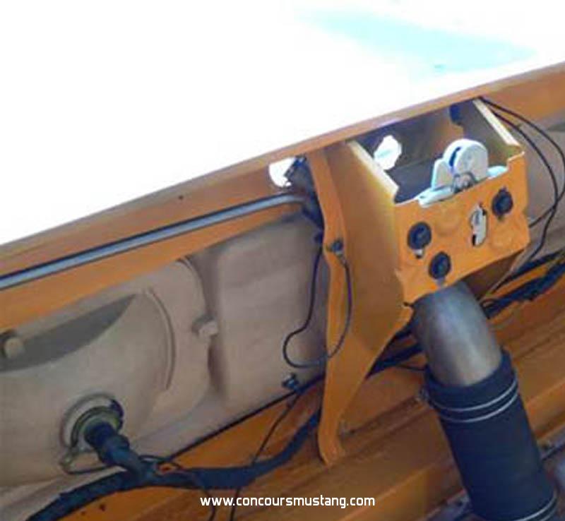

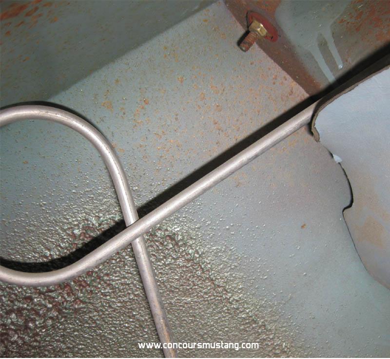

Here you go

Thanks for posting the pics AND the install instructions !!

Hey JEFF ... is the copy of the recall instructions you have readable ??
All the dimensions of where to drill the holes in the drop off and frame rail are really hard to read.   If these dimensions are in fact readable, can you post a BLOWN UP picture of the lower right hand corner of this drawing so I can read the dimensions ??
No it was a poor scan I got or found somewhere.
Might be one in the SAAC registry that covers the 69's
Pretty sure that the measurements were a guide and possibly not followed exactly in every case. But a great place to start

I finally got the vent tube from CJP last week and have it mocked up in my trunk.   They thankfully shipped it in this huge 12x16x37" box filled with air pillows so they did not tweak the tube to get it to fit in the box like they typically do for tubing.   Tube actually makes a bend towards the drop off (vs. pointing straight down as shown in the recall diagram), so I will just put the hole where the tube is pointing at.
Dimensions on the blurry drawing appear to be 4" from B-U lamp hole and 4" down from the drop off which closely matches where the tube is pointing to.   If these two dimensions really are 4 & 4", the drawing is definitely NOT drawn to any scale as the horizontal 4" is 2.5 times longer than the vertical 4".   Then the frame rail dimension appears to be 6" back and 1" up which would not line up with the other hole like the drawing shows.
