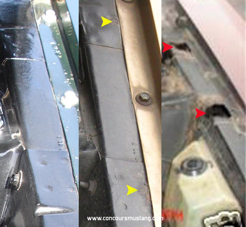

Re: 1968 shock towers
« Reply #4 on: March 19, 2018, 12:05:51 AM »
That is rust damage cause by moisture getting in between the different layers that make up the shock tower area. It is a very common problem for cars in rust prone areas.
+1  No your car was not delivered originally with that gaping hole. As the rust builds and converts the sandwiched metal oxidization causes it to expand creating a risen "bubble" which with continue to rust until it breaks through or an owner pries, cuts through or digs out the area as yours has. Your car has four of these areas. if one is gone others may be on their way.
How they look - far left
Rust starting to peek through - middle
Rusted through - far right
Offline tmahle
  • Posts: 38
Re: 1968 shock tower rust
« Reply #5 on: March 19, 2018, 09:09:22 AM »
This is very good news to me.  Here I thought the shock tower was replaced and someone cut it out.  Based on photos it is suppose to have a 1/16 drop down.   I only have one piece of sheet metal that is not original were the battery sits that has been replaced i suspect due to corrosion.
 Do people just clean up those rust holes and drop in a small piece of sheet metal and clean it up by grinding out the welds?  Mine is solid underneath so only the top is gone.

What I have done in the past (worked for me)
1. Create template to identify spot weld locations
2. Cut out rot - squared off for easier repair.  Top and bottom if necessary.  If your bottom piece is solid you are fortunate
3. Match sheet metal gauge, fabricate replacement pieces
4. Weld through primer on hidden areas
5. Weld new pieces in
6. Replace original spot welds.  If you don't have or can't borrow a spot welder, these can be simulated.  Search through old postings as this has been discussed a few times.
If there are alternative ideas out there someone will certainly chime in.
Keep in mind that as rust repair goes, what you see on the surface is only about half of what you can't see. If you don't cut out ALL of the cancerous  rust it WILL come back.

Offline tmahle
  • Posts: 38
« Reply #9 on: March 21, 2018, 11:25:22 AM »
Since writing this a local mustang expert came over and looked at it.  He also suggested just as you did to cut all if it out and replace that entire portion and respot weld it.  I could not understand why do all that extra labor  when it was such a small spot but you explained it perfectly to me to remove all the unseen cancer.  Who would want to do it all over again.
