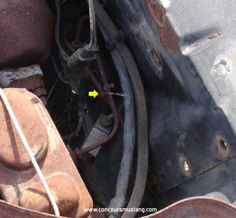

From 67 PB  applications - There is one located up by the master cylinder that holds the front and rear feed lines apart.
7R115xxx
7R211xxx
OK, it seems I may have now found a replacement large "3" clip for the lines near the master cylinder. I have also noticed now that the OTHER THREAD for late 67 has been started for discussion (circa after February 1st change-over date), that Jeff posted this one image of the later car from the other thread.
1st question: From these two images (above), it would then be assumed that the EARLY & LATE cars ALL used the same larger "3" near the master cylinder. Is this an accurate assumption?
2nd question: Since the smaller "3" clip found about 5-inches back on the straight section in the trans/driveline runner has been found to be olive drab on at least 2 examples, perhaps the larger "3" clip is also olive drab?
3rd question: Refer to image below with a 2nd LARGE "3" clip found on a later car (notice brake line is under the column, thus late production), I could also assume this 2nd larger "3" WOULD NOT BE FOUND ON EARLY CARS, is that a correct assumption?
