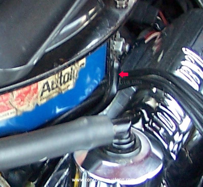

A picture from the following thread might help you out
http://www.concoursmustang.com/forum/index.php?topic=10002.new#new
So that should answer the coil bracket and the shaker to intake support. The throttle bracket from my understanding would also typically be P&O
I can't really tell from the pic but are you saying the shaker bracket is also P&O?
Carl
70 and 71 Dearborn mach Is
Re: Throttle Cable and Coil Brackets
« Reply #6 on: May 04, 2018, 05:40:16 PM »

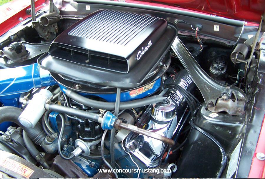

This help?
Appears to be semi-gloss black (may be dipped) finish, to me

« Reply #7 on: May 04, 2018, 05:45:43 PM »
OK, so I guess mine is correct then. ;) Although I can't tell if dipped or sprayed or gloss. Funny what 48 years will do...

Thanks for all the input guys, I suspected the coil and throttle brackets where P&O but wasn't sure about the shaker support bracket, but will be finishing it in semi-gloss black.
