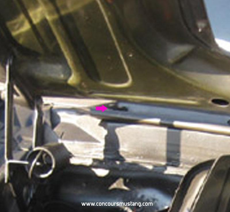

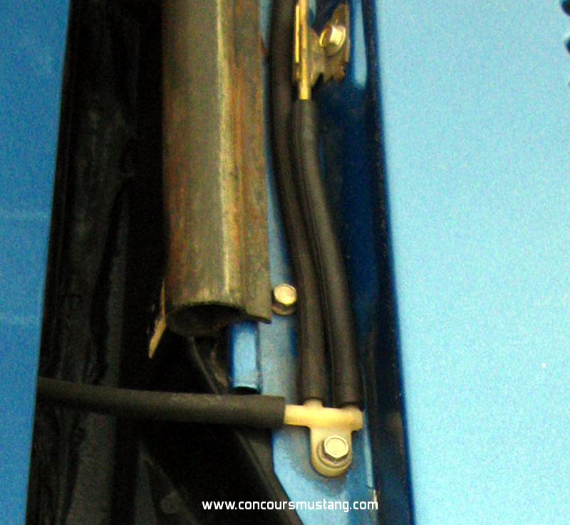

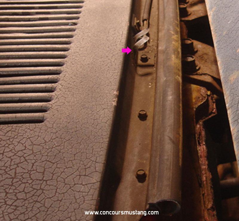

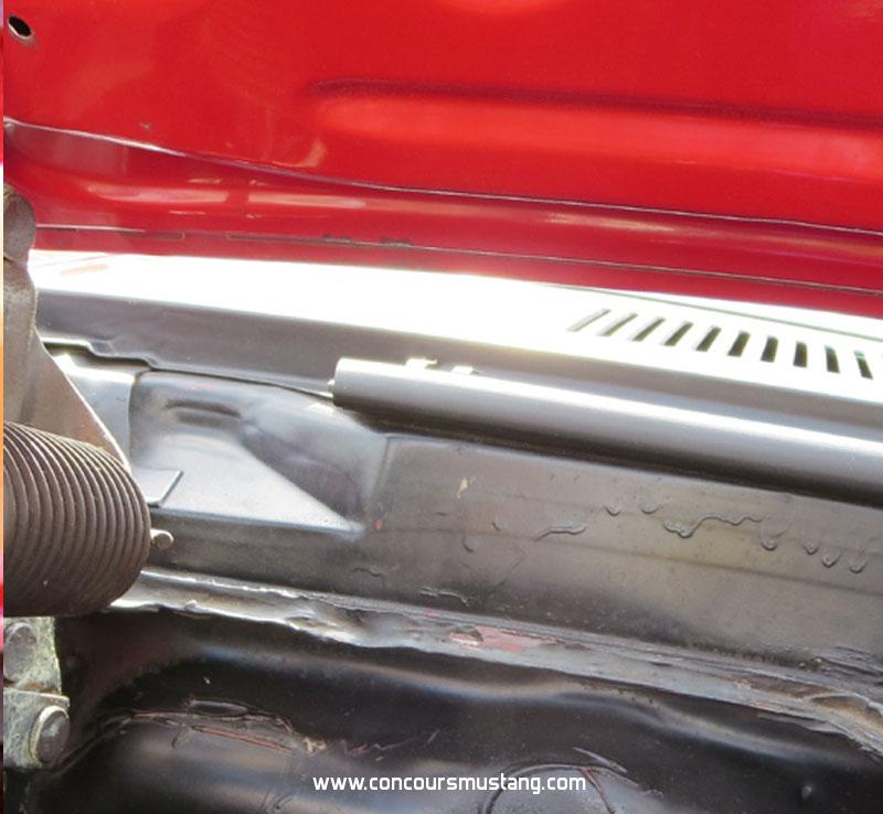

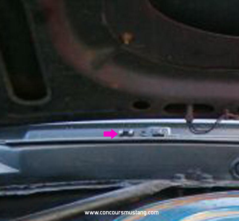

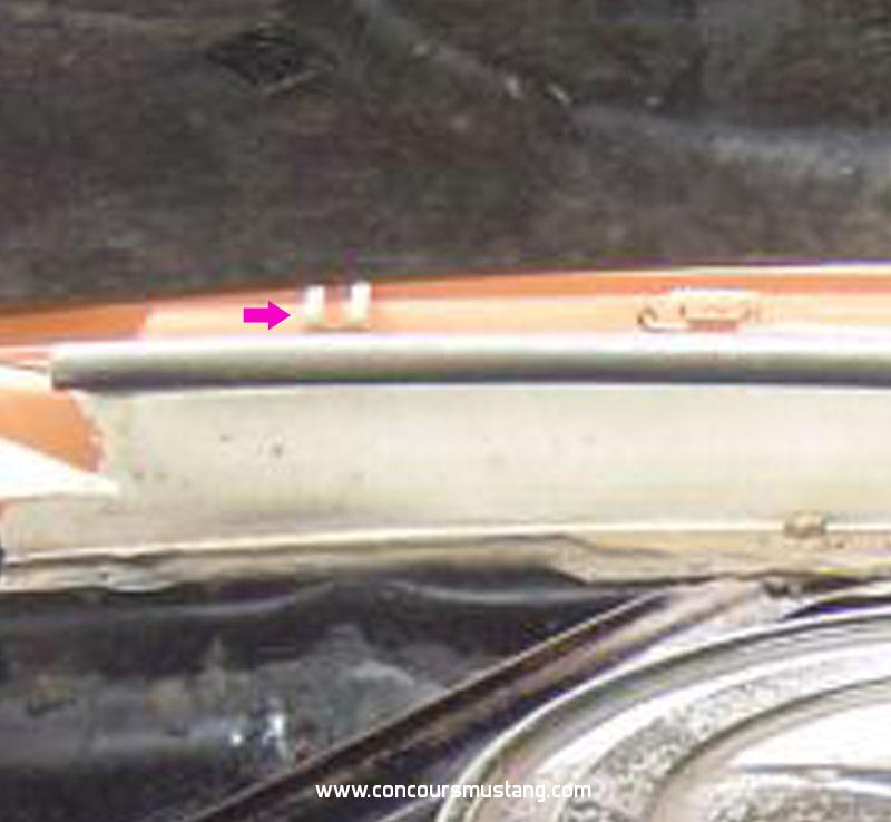

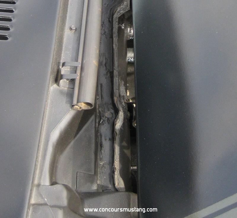

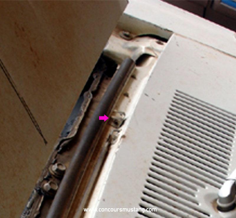

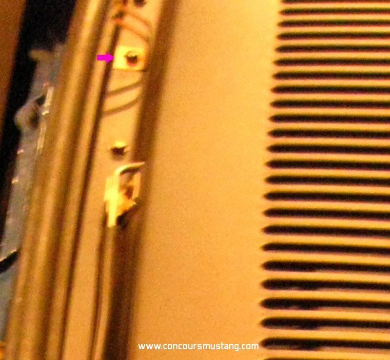

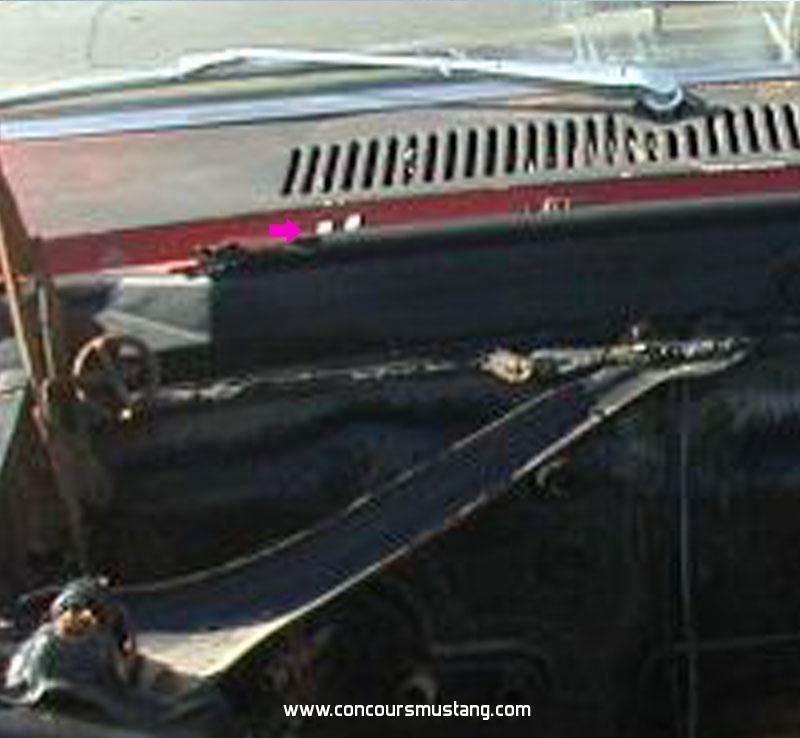

Every so often a new detail appears out of a search to answer a forum or email question and over the last few days another has arisen.
This time it's related to the location of the hood electrical ground strap attached over the cowl cover of 69 Mustangs and Cougars on the passenger side. Though a small detail all of them working together breaks the cookie-cutter look of the finished cars and  represents, how the cars were each built, our goal
Only included three pictures from each plant though I have dozens of additional example from each.  Hope this helps
Metuchen
San Jose
Dearborn

So in summary the survey shows that all three locations  (first three cowl cover screws on the passenger side) were used for mounting the hood ground but typically they differed from plant to plant that year.
#1 or furthest outboard at San Jose
#2 or middle location for NJ
#3 or closest to the windshield washer nozzle, typically, at Dearborn
Who would have thought :)

All 69=70 cars should have cowl rubber seal. Agree jeff as i have 4 Met. cars in the area & they have ground straps on center screws not by washer jets like i see on dearborn cars. I am working on a early feb 69 Met. car now & am wondering about the color of the cowl body color vs. black as it seems like Met started paint cowls black way before dearborn. In your Met. ground strap photos all seem to be black color do u have the build dates on those photos? thanks
