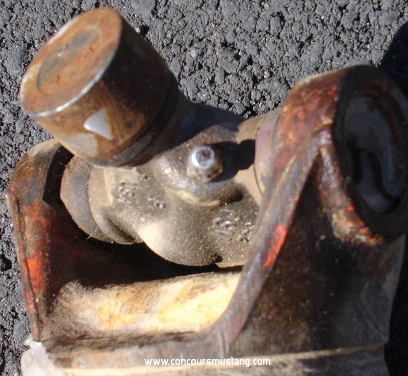

Looking at build sheets for similar cars (don't have any specifically for 68 390 4V auto) that likely used the same driveline I offer the following for consideration.
1- Do have  on photo of a 68 390 4V automatic driveline with markings and visually they look the same as far as stripes
2- Pictures and buildsheets for these other applications (specifically 68 KR or CJ automatic)  all appear to have the same color stripes for identification. One difference is that they are listed as (in reverse order when listed on the buildsheet) as light blue, dark blue and red.
3- Since we're dealing with digit pictures and the colors can be off would at least offer that in some the "white" looks to be bluish and might show a truer blue if cleaned off more and the top layer stripped away
Driveline yoke ends were painted for identification purposes and before they were installed/welded to the driveline tube so the paint would be burnt in areas near the welding as shown in the driveline restoration article posted in the Library. On the same drivelines mentioned above in pictures the ends have the remains of orange on some of them.
Do have automatic C6 trans yokes with which are a bit brighter than the color you posted. They are somewhere between Fuchsia and the Pink posted in the color chart part of the Paint Mark article in the Library

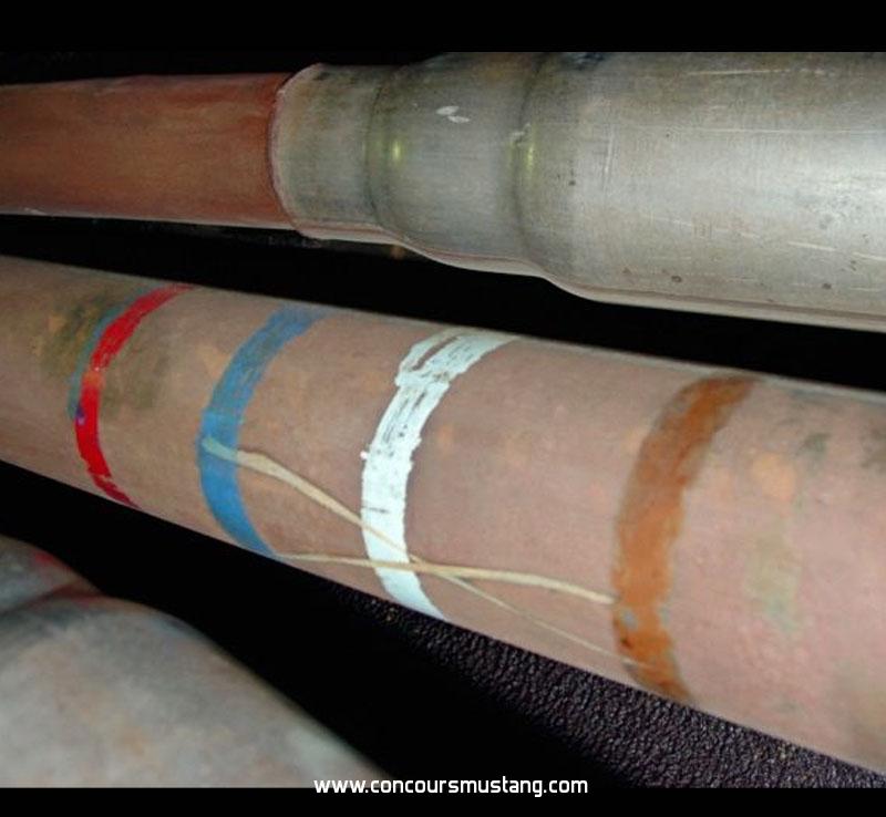

Thanks very much Jeff, that solves the mystery around the shaft yokes and C6 yoke too.
My "white" stripe is definitely white, the iPhone photo actually came out pretty true to life this time. I did use some cutting paste on one bit to see what the color was like, sharing your view on fading etc,  and its just the same, only brighter. :-)
BTW this is a 3" driveshaft vs. the 3-1/2" ones, (if that makes any difference), and I have seen another unmolested 3" 1968' 390/C6 shaft with the same 3 stripes as mine. I noted that the "Dead Nuts On" 390 driveshafts also use this combination in their webshop picture (attached), so perhaps its correct?  Although I note that suspiciously both their 4 speed and C6 shafts use the same webshop photo... They do however, also say that striping arrangement is used for 1967 (see their graphic attached). Do I see a pattern developing? Was 67-69 the same for color codes using the 390/C6, I guess that makes sense?
The other photo, (old shaft by new) also shows that, albeit with the end yellow rings added. I have heard several versions of what these extra 2 stripes mean, most commonly that the 3 colors grouped together are for engine & trans, and that the others are for misc. plant specific purposes on the assembly line. Still all I have in that respect is a less rusty ring with no paint remaining, on one end. A bit hard to say with any certainty what it was... :-(
I wonder too, was their variety amongst the plants? I did read somewhere that the shafts were all done by Ford (in Dearborn) then shipped out to NJ, SJ or wherever, is that true? In which case they should be the same for all 390/C6 assemblies??? Do they vary between 2V and 4V? It is I think its fair to say, that this is an unmolested 390/C6 Mustang driveshaft, but thats all I could concretely say. But if its not what came with my 4V 390 / C6 car, I can at least do my best to get it right now.
Anyway that's a big help Jeff, as I can at least do the yokes now. Although one last thing on that part. Were the yokes completely painted orange / pink or was it just a brushed on portion or them? Mine have no paint near the UJ bearing holes, but then that could have been knocked off... The C6 yoke seems to just have a big daub of pink, not a complete covering.

............. Was 67-69 the same for color codes using the 390/C6, I guess that makes sense?
Not what I've seen, have records of or buildsheets support at this time IMHO. Would be careful mixing and comparing details outside of the time frame your focusing on since there is history of color stripes changing two or more times for the same application in the same production year. I would disregard anything related to any other year.
Hope Jack doesn't mind you taking his pictures (hope you asked) but I don't see a relationship between those markings and yours. IMHO I would just stick with what you have
Though it does not directly relate to you spring built car earlier big block automatic equipped 68 Mustangs and Shelbys also carried the same Light blue, Dark Blue, Red markings according to factory documents. Likely a group of 60 cars or so. Just got another stack of 68 buildsheets - haven't gone through those let but expect they will be identical in this area and the others I have
Could the driveline provider messed up on yours or a small group of the same drivelines? Maybe but it would have likely created problems in the line when the worker read the sheet and went looking for the matching driveline. Guess it could have been caught early and all the mismarked ones placed in the bin thatg normally held that application's (BB with automatic) driveline and the worker choose from that bin since he always took from that bin for that application. Basically a work around
The marks at least the identification ones are clearly the same at all three plants if you stay with the same application and time period. This can be documented by the buildsheets.  The ID markings were applied at the supplier not at the assembly plants. Not sure who the supplier was or if there were multiple suppliers. Have only run across one worker that had anything to do with the production of the drivelines over the years and that was through a good friend
One word of warning and that is likely too strong of a term, about reading allot of stuff that has been placed on the web since it became available to the public . Just a word of caution as always

Typically, yoke end were orange and not 100% coverage. The pink on the slip yoke is the same, not 100% coverage...just an ID.
The light blue, dk blue, red driveshaft was also used on NJ built 428 Cobra Jet cars and 428 PI cars with automatic transmissions. So, I suspect it is the big block driveshaft for all auto trans cars.

I think its going to be all big, block automatics... the all show p. no. C8ZZ-4602-C in the MPC. The is reference to some 390s using a different driveshaft that is slight longer than the one you showed in this post, but it is a 3 inch diameter.  The only other 1968 big block driveshaft is for 4 speeds.
...that would include the 390s (including X-codes), 428PI and 428 CJ. I seriously doubt each of the colors have individual meanings.
I think its unlikely some swapped out the driveshaft with the one you showed above, unless you know your car does not have the right drivetrain. Listen to your car.
