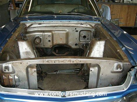

I found this when my '64.5 was getting rebuilt.  The ones on the side are a little hard to see, but it looks like this was used as a press car.

Dearborn?  Around when was it built if you don't mind?
Also if you know it what is the DSO. The CA might indicate California for emission purposes

That's interesting!

Yup, Dearborn built.  Don't have the door tag (was removed before I bought it, probably during one of the 3 or 4 paint jobs), but it's #3219, and best guess on build date is March 23.  (that's from finding VINs on either side built on the 23rd over at the Early Mustang Registry) No idea on the DSO, I bought it in FL in '86 from the 2nd owner.  I couldn't figure out the CA, but I mentioned it to Gary Patterson in Indy before the banquet, and he said it would be a Cali press car.  But as I've looked at it again, and again, and again, it looks like it could be an R after the CA, so "PRESS CAR" is my guess on that.
I need to try to enhance the left side markings to see if I can see what the original color code was.  I found some unmolested areas on the car when it was being repainted a couple years ago and saw what looks like turquoise in places.
