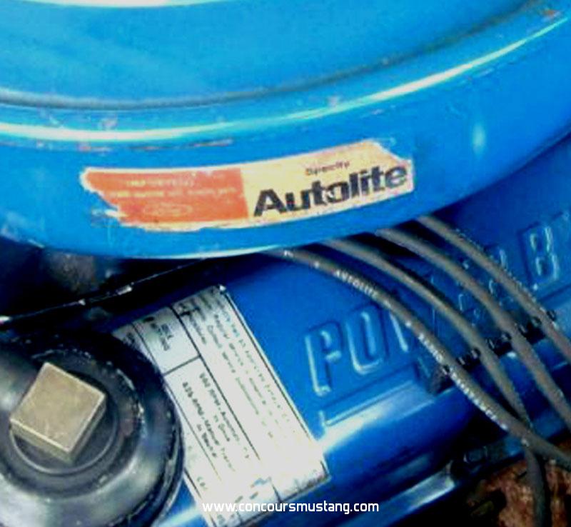

Yes Marty there were two versions used at all three plants during 68 production. Agree with Royce that the exact change over date is likely a soft one and slightly different depending on plant and even engine option. But in general I think we can narrow down the change to a fairly short window. Best we can do without being there and without having all the real build dates of cars we use as examples
Though most unrestored cars only have the adhesive remnants of the paper based sticker we have a few that are still legible that I was able to find. Invite others with original examples to add to the discussion or at least data points
Let me offer the following after looking through what I have available
Looking at just small blocks I found the latest vehicle I have pictures of with the early version of the sticker was 8T03J1186xx (approx mid Nov 67 build date)
The earliest example with the later version of the sticker (element part number listed) as 8R01C1426xx (approx mid Feb 68 build date)
Now if we step back and look at other engines we have original pictures from 68 with one of the famous 135 cars (68 Dearborn built 428 CJ cars used in the initial drag program) with the early version of the sticker. So this would give that car an approx end of Dec 67/first of Jan 68 build date.
So it appears that a general range could be suggested that the change over was in Jan-Feb 68

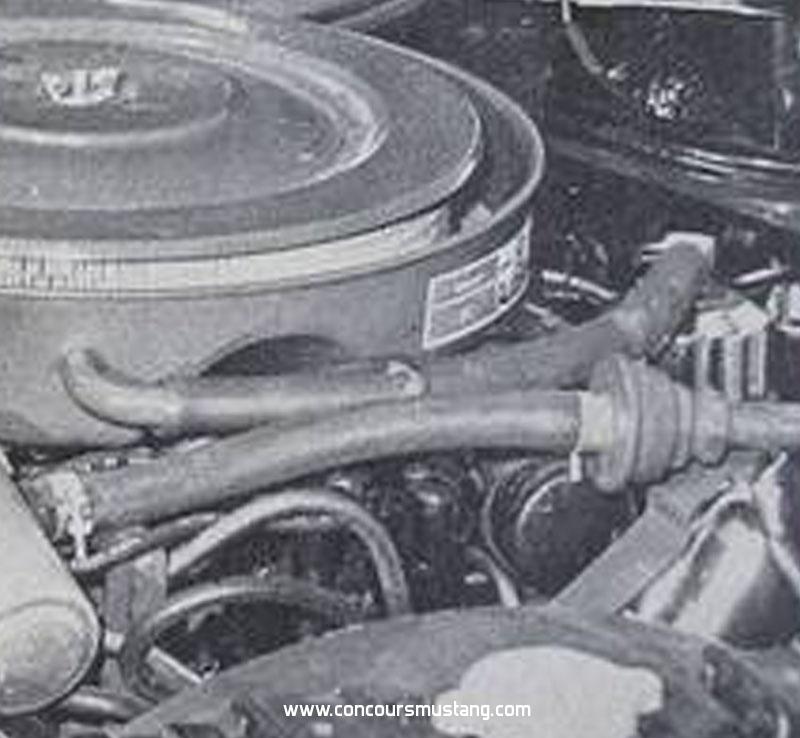

Guess we should ask Marty where the two cars he posted fit in to my time line of my earlier post (VINs and projected build dates)
Royce might be able to associate a possible build date or VIN for this car with the early version

That particular car was painted red later when Dyno raced it, or I should say attempted to race it at the Indy Nats in '68. He was disqualified over a disagreement about the weight of the car due to erroneous information from Mercury sent to NHRA.
I seem to recall the car was a May or June '68 build, so well after the change of stickers. It has not surfaced to date so far as we know.

« Reply #5 on: July 21, 2018, 11:12:38 PM »
Thanks Royce.  Seems odd that they would have given the car to them to use so late in the production year.  Oh who know why at this point.
Don't want to get off topic so won't mention a few other things we could discuss in that picture  ::)

The black 1968 XR-7 428CJ 8F93R589867 (scheduled build date 26U, actual unknown) automatic raced by Don Nicholson has been found since the original post was made. It turns out the red 1968 Cougar 428CJ (VIN not revealed) raced by Don is a different car. That car has also been identified and is known to exist also. The red car is a standard Cougar with 4 speed, a very rare combination.

Jeff- The grainy picture you posted of a 135 air cleaner- was it from the March Hot Rod Mag? You can see the left 1/3 of the decal- I have looked everywhere for it to no avail. The base of the air cleaner for those 50  135 cars was actually from a 1967 Thunderbird. There were a number of variations in the air cleaner from the 68 1/2 cobra jets.
