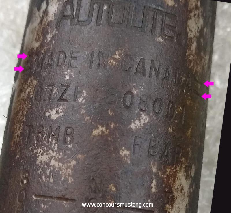

While rummaging around on the Shelby parts shelf looking for clutch parts to restore I found two original Autolite rear shocks! I didn't really recognize them earlier as the previous owner had undercoated the car -- and the shocks.
In looking at what I believe is the date code I can pull out a 6M, which works well for my build date, but how is the whole line "T6MB" decoded?

Nice find!
As shown on page #35 of the article about Date Coding in the Library ;)
They would decode as we understand it right now as Plant - Year - Month - Shift

Looking into the 67 Shelby adjustable shocks provided by Gabriel I was reminded that this might be a good time to share some findings
So far I've found two versions of the AUTOLITE shocks that I discovered on original shocks installed on these cars during production while looking through the examples I have in photos found and shared with me. Front shock markings seem to follow the same production pattern.
1- AUTOLITE marked shocks painted semi-gloss black. This first version had two horizontal lines to the left and the right of the MADE IN CANADA and but none to left and right of the AUTOLITE.
Production of this style appears to end in Dec 1966 (date on shocks). Reposted Bill's picture from above and added arrows to identify the lines.

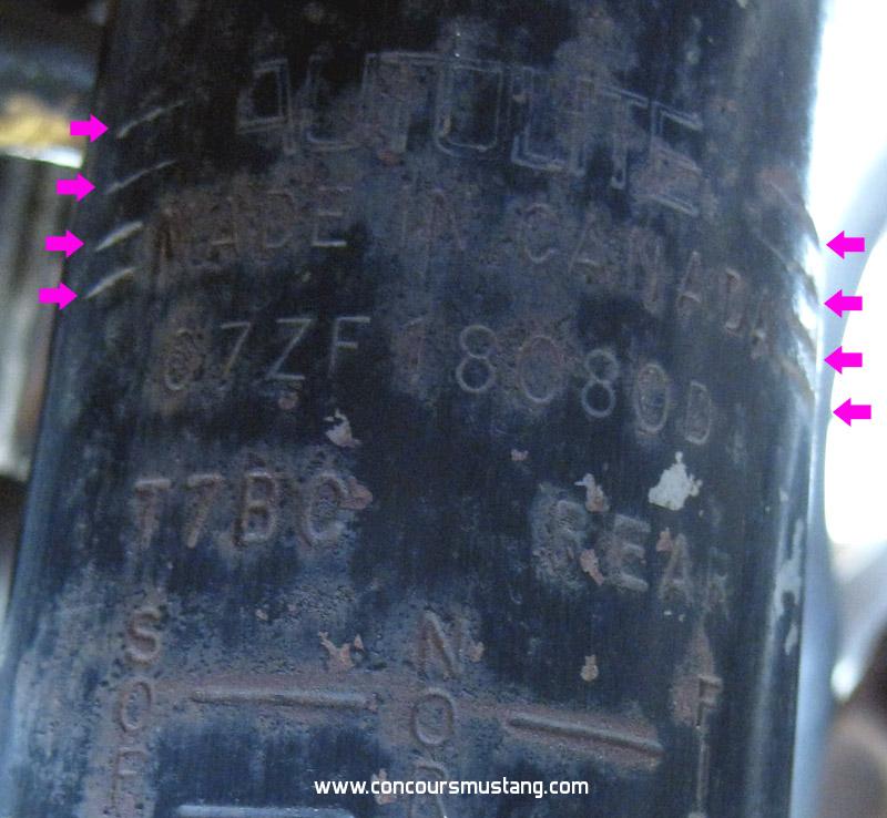

2- AUTOLITE marked shocks painted semi-gloss black. This second version had two horizontal lines to the left and the right of the MADE IN CANADA and to the left and right of the AUTOLITE.
Production of this style appears to start in Jan 1966 (date on shocks)
Looking back to Bill's posts it appears he car originally (for the rears) was equipped with one of the earlier and one of the later versions of the AUTOLITE.  Likely others were the same during a transition period

Was going to include that very early version also but choose not to in that post. Thanks for adding it in.
Is that the latest date you've seen on assembly line FoMoCo 67 shocks?
So I've got so far
1- up to Oct 66 the FoMoCo script stamping
2- Nov - Dec 67 made with AUTOLITE and lines
3- Jan 67-up made with AUTOLITE and no lines on either side of it
Think we have the whole year mapped out
