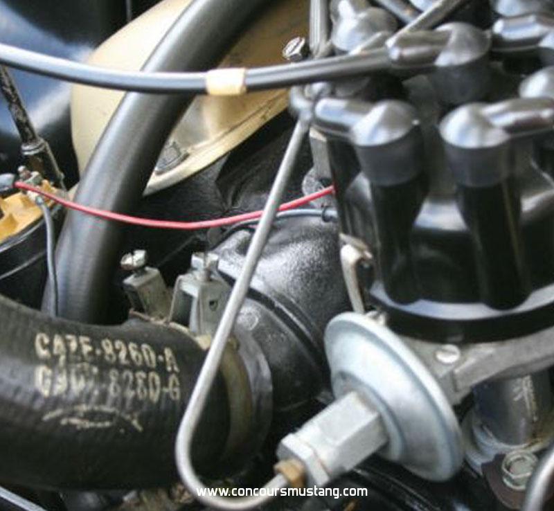

Should the fuel line run behind or in front of the distributor and which bracket should I use?
Which bracket?? there is only one bracket and clip that I'm aware of

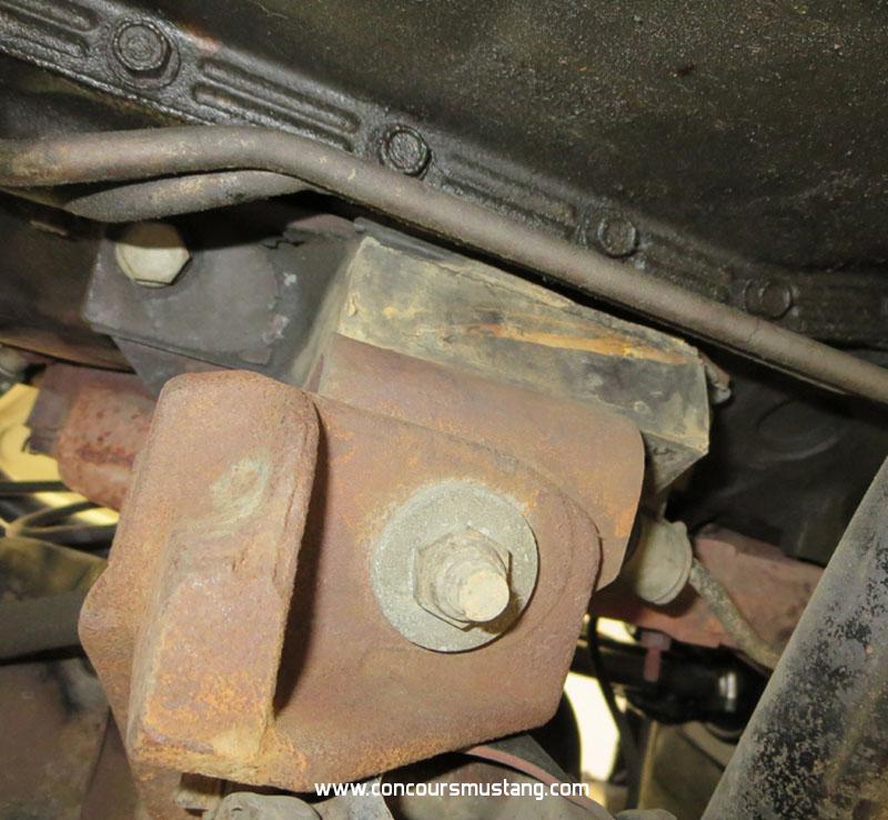

Should I use 1 or two starter motor cable brackets?
At least on this examples -  one
If the part number on the cable assembly is C5ZF-14431-A (or -B), there are two cable clamps. In 1966, the cable assemble was C6DF-14431-A using only one clamp. I found an original C5ZF-144312-A on my Oct 65 San Jose Fastback. (It said Canada on it as well.)
  • Posts: 24867
Re: Sept 64 289 Convertible questions
« Reply #4 on: August 20, 2018, 05:28:37 PM »
Jim - have to disagree. Are you basing your comment only on your one examples or do you have more vin's/cars to support it?
I found plenty of examples with a single from mid summer to early 65 at San Jose and other plants - the basis for my statement.
There does not seem to be a consistent (always) pattern on these just going by the majority and the close other examples and evidence found on them. Picture posted is from another Oct 64 San Jose fastback and it only had one.
« Last Edit: August 20, 2018, 05:31:16 PM by J_Speegle »
This is an October 65 build 66 Mustang that had an old starter cable assembly, C5ZB-14431-A, with two brackets and a "disintegrated" insulation sleeve, so I replaced it with a reproduction assembly of the same assembly number. I assume that I had a situation of Ford using up old stock, a 65 part on a 66. This was discussed with the two previous owners who told me what they had done to the car before I bought it. To continue this a bit further, 64 Mustangs, 260 and 289 engines, used part number C4ZF-14431-A (or -B) that is shown with one bracket in the 64 Electrical Assembly Manual. I again will state - one or two brackets depends on the assembly part number. An early 65 may have used a 64 cable to consume existing stock, hence one bracket.
When the part in question found on a car reflects the part number on the Ford Assembly Drawing, you have accept it as accurate. A picture might be worth a 1000 words, but the part number is the final deciding factor.
  • Posts: 24867
« Reply #8 on: August 21, 2018, 12:24:56 AM »
This is an October 65 build 66 Mustang ................
Maybe that is at the core of the difference since the period in question is Sept 64
Guess just a point were we're going to agree to disagree. But that's ok.  Your referring to the cable while the question is the retainers/brackets that connect to the motor mounts.
« Last Edit: August 21, 2018, 12:34:37 AM by J_Speegle »
