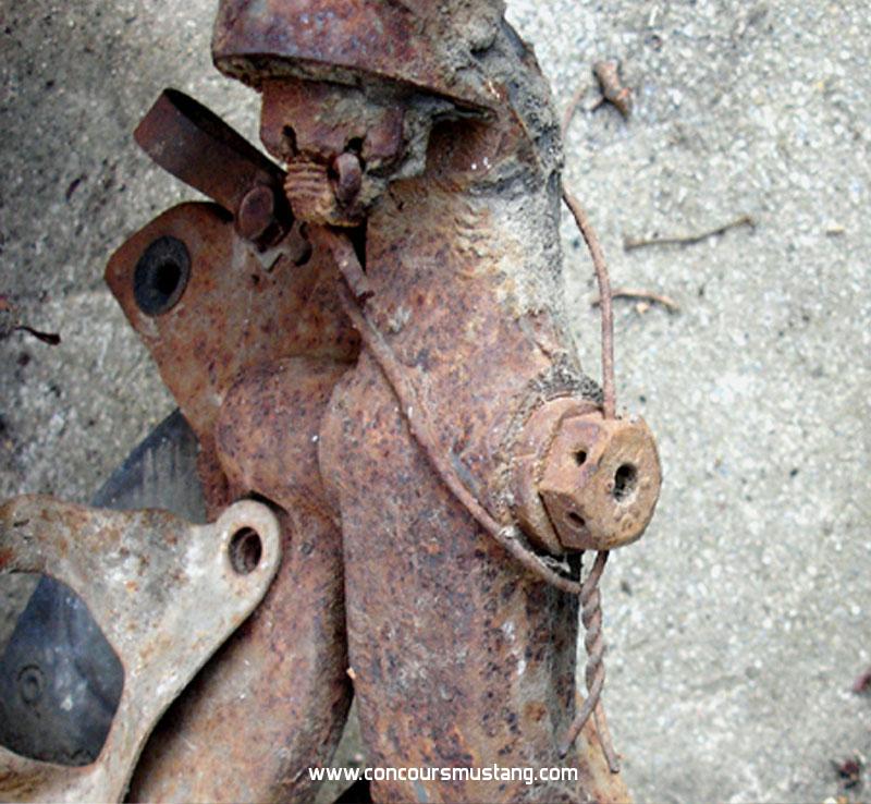

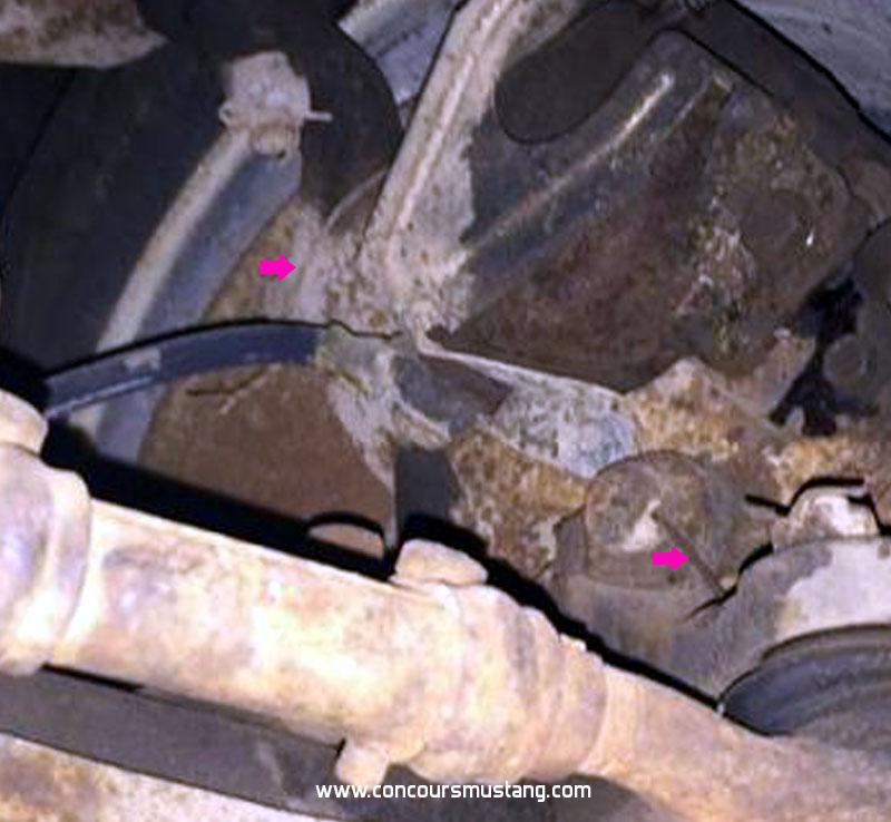

Jeff, would Royces pic above of the safety wire installed be typical ?
Re: 1968 Disc Brake Caliper Safety Wire
« Reply #4 on: September 16, 2018, 04:47:15 PM »
For 68 at Dearborn?  Let me look at my pictures
From the first post IMHO at least the one to the left is not like any I've seen since it would allow the bolt to loosen and the safety wire would not limit its movement as designed and the wire is laid over the spindle stop that was originally machined and is designed to contact the stop on the end of the strut rod. In it's current location it runs the risk of being smashed or cut by that surface bottoming out on a hard turn

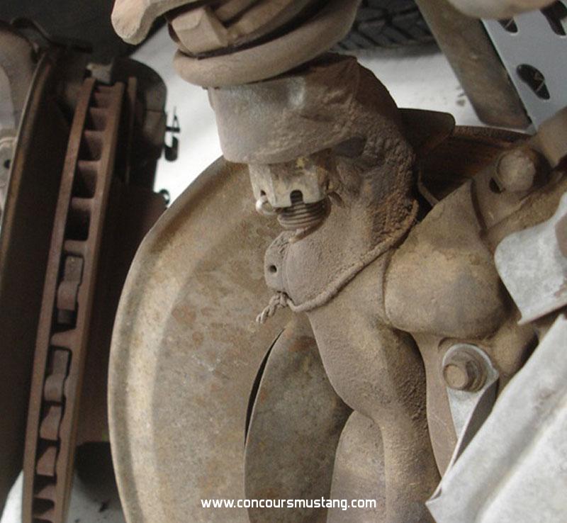

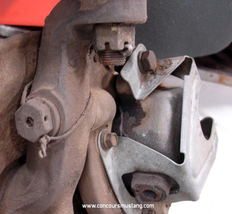

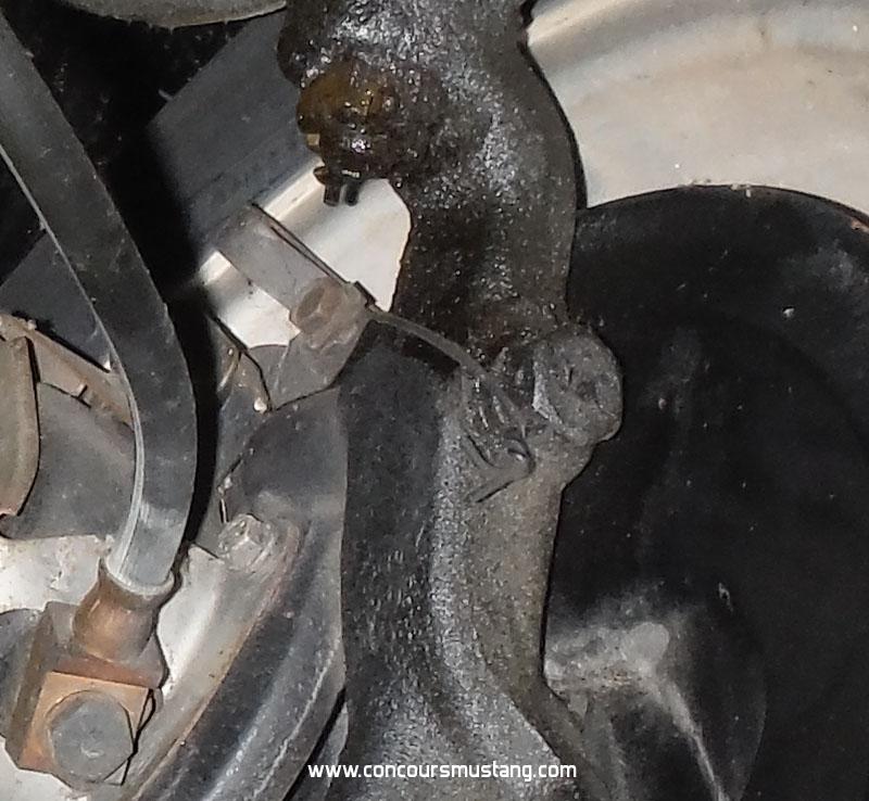

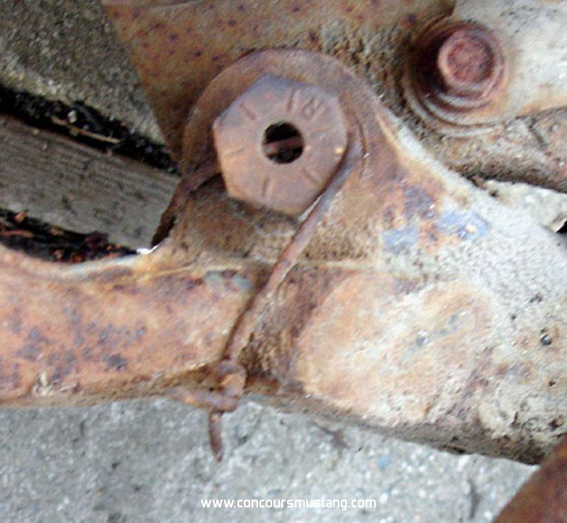

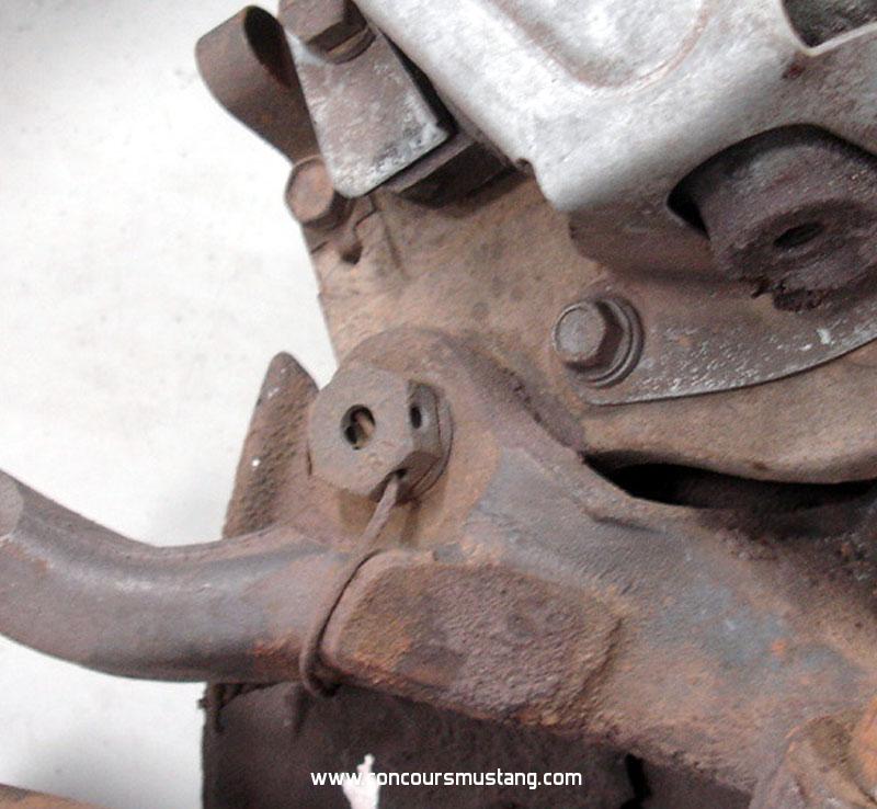

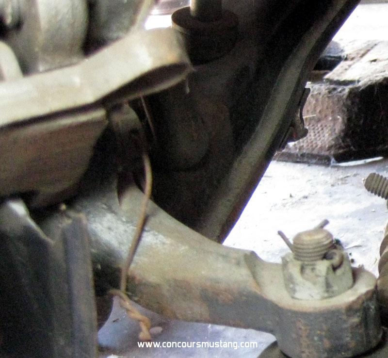

Have some pictures of the spindles on and off cars so unfortunately don't know the specific year and plant for each. Do know that one of the upper and lowers are from a 69 Darborn unrestored example
As you will notice the thickness of the wire used, its location as well as routing and that it was likely tightened with some form of pliers but not the fancy style many use today that produces allot of nice neat wraps. Ends were often left fairly long just right for grabbing cleaning rags and scratching hands and arms :(
Upper bolt-
68 NJ example
And another
Lower bolt-
