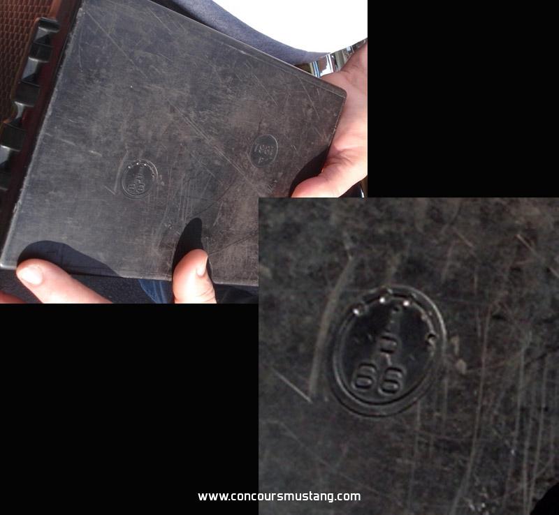

This battery was recently pulled from a 1966 mustang.
Can anyone here determine if this is an original autolite battery or a reproduction?
Note:  the 24R indicates its a reverse polarity, however this should mean the positive terminal should be on the right side.  I believe all first gen mustangs used 24F batteries, not 24R.  So if original, what car would have used a 24R, if not the mustang?
 Thoughts?

« Reply #51 on: January 07, 2023, 03:57:13 PM »
Reverse post applications were typically on MOPAR's given the battery was typically on the driver side.
  • Posts: 9519
Re: Group 24 batteries
« Reply #52 on: January 07, 2023, 04:02:52 PM »
The picture shows a group 24 reproduction battery. It may have been pulled from a 66 Mustang but that is not the style that would have come in one from the factory.The battery is the typical repro Autolite battery copied after the 68 up version. The battery is not a reverse post battery. Many of the repro batteries came with the 24R on the sticker. The 9AA date code was copied also which is seen on this sticker. I doubt the mfg had any idea of what he was coping when he did. FYI the repro Autolite batteries have been MFG in various forms for over 30 years now so don't be fooled . Genuine assemblyline batteries typically have added date codes heat stamped into the topside of the case. They also have date codes cast into the mold of the bottom side of the case. Repros will many times have the repro MFG mark on the bottom side of the case.
« Reply #53 on: January 07, 2023, 04:15:17 PM »
 Thoughts?
Only as a side point not all first generation Mustangs received a 24F in fact I would think that most didn't but instead the 22F
And for dating early battery's for 66-67 for example had a casting date in the main case on the bottom
