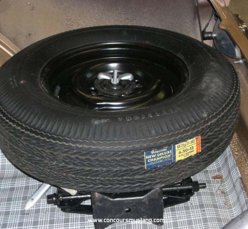

As for 69 styled steel here is a picture of Bob P's 52 mile 69 with styled steels. Matches jack instructions
Scott Fuller makes the 68 version with no tabs. You could check his site and compare the two

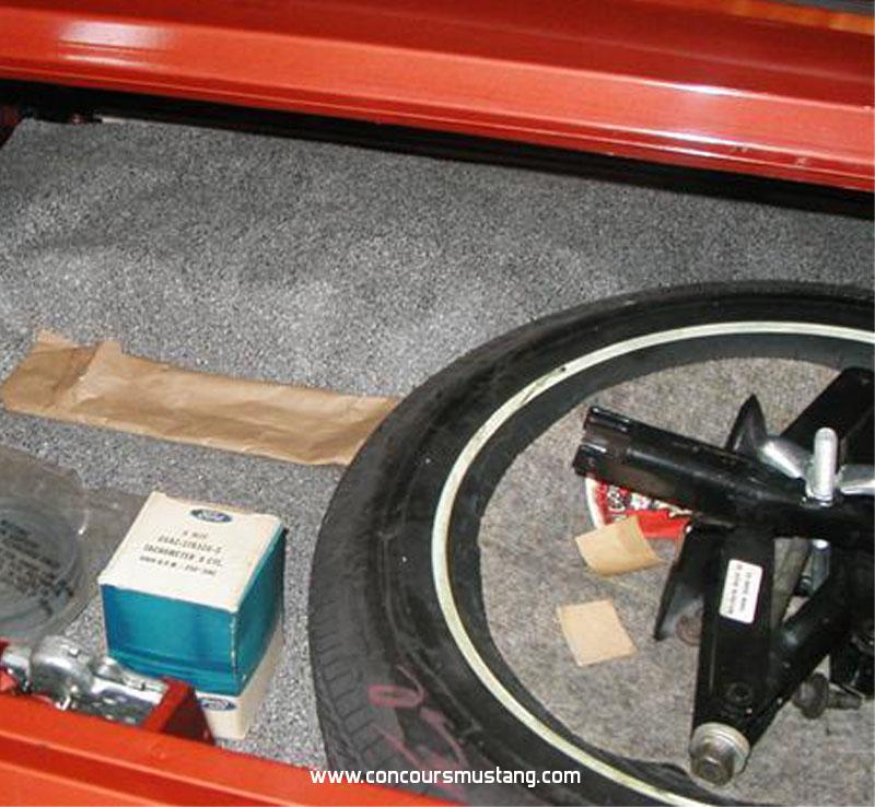

I did talk with Scott Fuller and he gave me permission to repost some of his pictures here of the C8MY version of the washer. It appears to be smaller than flat and 3-pring versions.
I also have a 60-67 version of the MPC Illustrated manual which shows the washer flipped on the (model 63) 2+2, versus the other models. It does make me wonder why they would show it if it had no meaning. Perhaps part of the J-hook length scenario?
I understand the MPC and Assembly Manual information is not necessarily what went on cars, as Jeff's pictures show ...

It's 4 inches in diameter. Lay it flat and it's 5/16 in thick. The material is 0.080 in thick steel. Per the original owner, Mike, and its second owner, Bob (I'm number 3), it is the hold down washer that came with the car. Whether it's Ford p/n C5ZB-1424-A as shown in the 65 and 66 body assembly manuals for Style Steel Wheels use or not, I cannot say. Strangely, the assembly manuals show its use for Hardtops and Convertibles. I have the original spare, a Style Steel Wheel with an original Dual Red Line tire, per Mike. It could be dealer installed.
(Note in the picture in the lower left corner that there is no "ribbing" on the edge of the Dual Red Line tire.)
