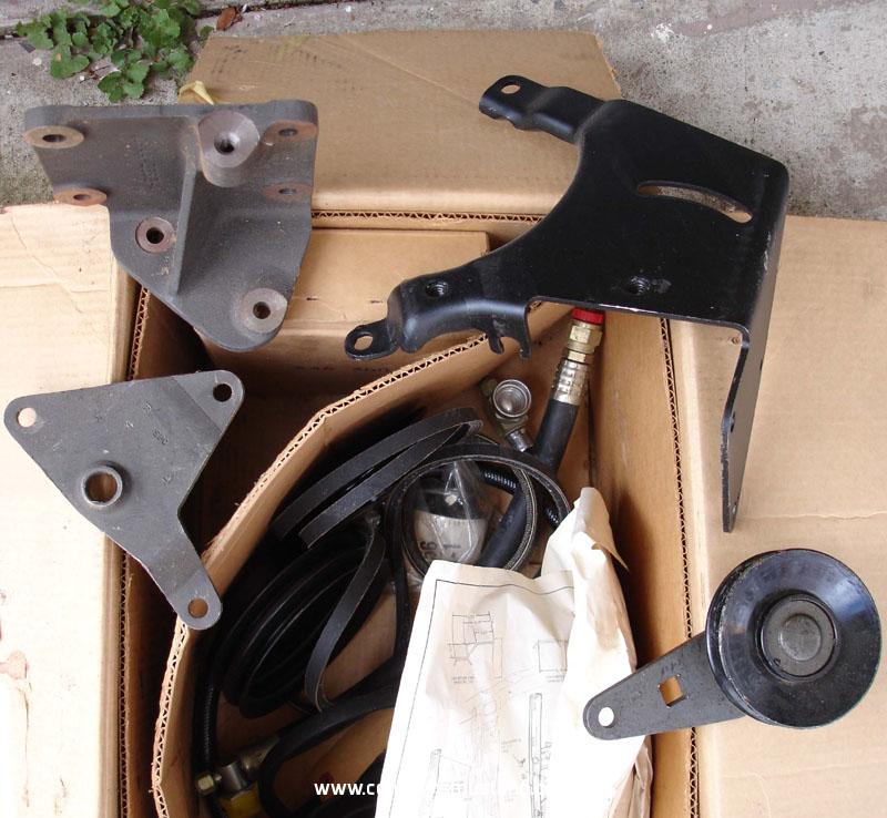

Close up of the adjustable idler pulley and bracket from a NOS AC kit
And some of the same brackets you showed in your first post

Pics of the AC Condenser and dryer.  Also the canister that I have no clue on.  Then a picture of the last of the unknown brackets.  The PS oil cooler appears to be the LTD Fairlane mentioned on google. The throttle cable measured a little over 23 inches from tip to tip.
J Speegle and Bob,
Are those pics for a 428 or 390 AC system or are they all the same.  That large bracket is like the one I have bust Mustangtek states for 390 I think. But I know the site doesn't swear by everything it says.

The AC condenser and dryer look like a 67/68 version. I can't tell from the pictures but the 69/70 uses O rings and the 67/68 uses flare fittings at the condenser so check that feature.  The vacuum can will work for 69/70. The sheet metal power steering hose locator bracket you can use. The piece with the two slotted holes is the chassis side for a manual trans Z bar. The bent metal piece is used to hold down a repro single four oval air cleaner base (junk). I don't know what the larger steel bracket is for but I do know it is not for a 390 /428 AC system.
