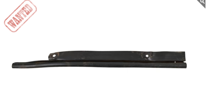

« Reply #23 on: October 31, 2023, 08:46:38 PM »
I found this on the WCCC website, but they don'y have any in stock. Now I know what I am looking for. Hopefully one turns up eventually
Re: 1968 Fuel Tank Sending Wire Protector
« Reply #24 on: October 31, 2023, 09:21:53 PM »
Don't be surprised to find most are deformed and distorted. They are mounted 1/4 to 1/2 from mufflers  on most applications. Given the close proximity to the muffler they are victims of the heat.

« Reply #25 on: October 31, 2023, 10:53:52 PM »
Well that explains why you never see one other than the remnants left behind. Hopefully I find one, but I am not holding my breath
