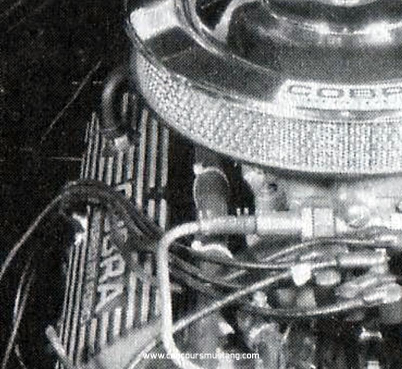

« Reply #4 on: February 22, 2019, 04:54:40 PM »
Though it doesn't help with the part number at least the period picture helps confirm the design and the basic look/finish
