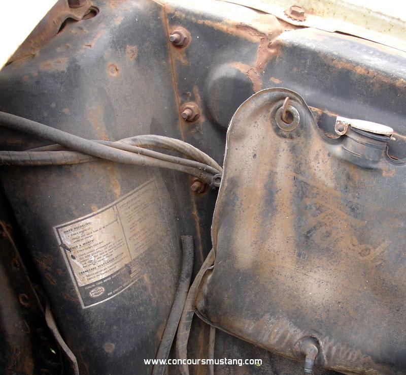

- Service specification sticker shock tower. For others this location appears to have changed later in the production year to the passenger side shock tower.

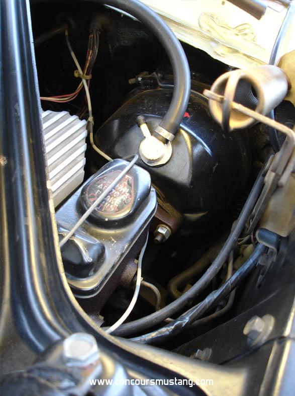

- Master cylinder brake fluid warning label.  Your car would not have had the red paint mark on the PB booster originally so please ignore that in the example. Also used an example from a Shelby so there are other things in the picture you will need to ignore - Just focus on the detail being discussed

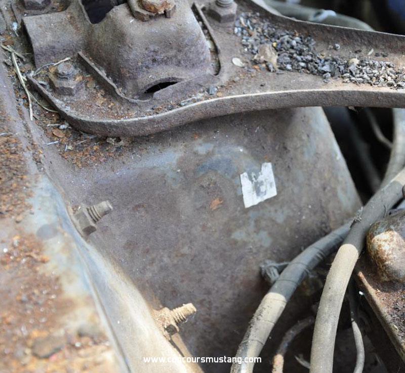

- Battery inspection sticker Often above or above and forward of the starter relay.  Most likely the blue print version. On paper sticker with no clear top layer applied

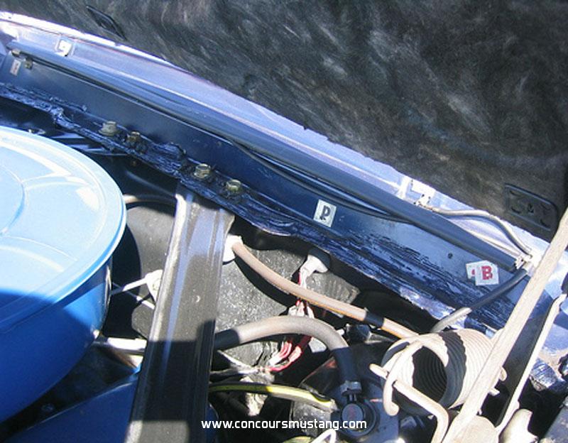

- Misc inspector stickers on the cowl above the cowl to firewall pinch weld. These would be small square cornered stickers with large red or black letters and sometimes an additional number. On paper sticker with no clear top layer applied. For this year and plant have seen where the inspector wrote their ID number on the sticker before they applied it to the car for accountability. Looks to be black ink which would be period correct
