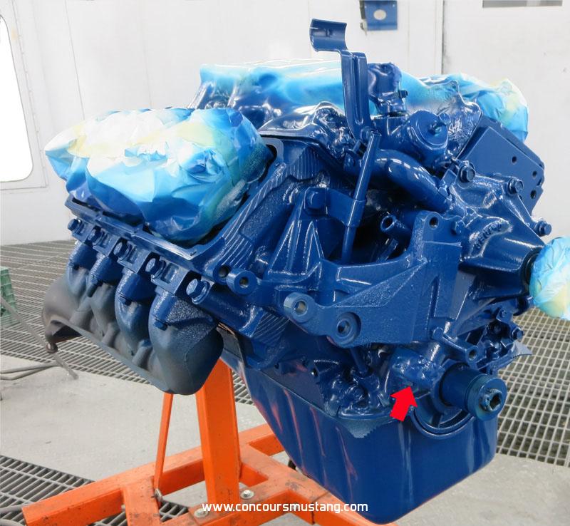

"Restoration"   using a crossflow radiator   :o.  But to your real question
Lower hose connects to the water pump where the red arrow indicates. Lower passenger side of the engine front
