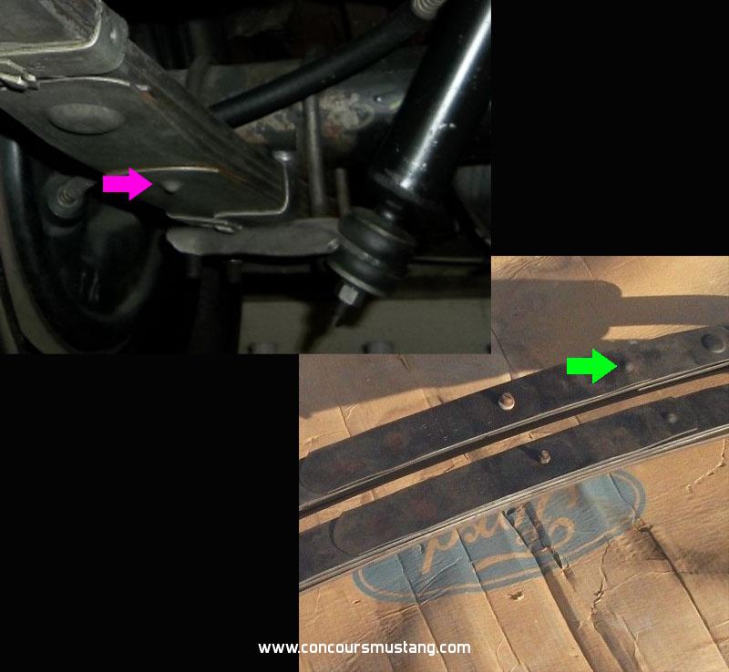

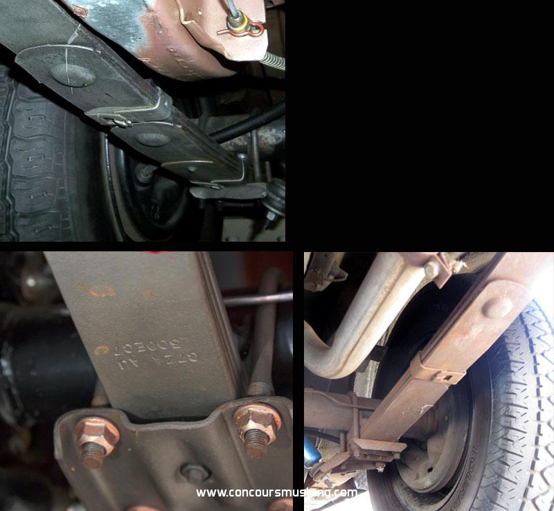

There were multiple different design (dimple, pointed dimple and no dimple) found on the short leaf on cars built at San Jose during 68 production. This may have been the results of multiple suppliers/providers who may have supplied one specific rear spring or more to San Jose at that time. On some springs we find one of these physical details (dimple for example) while different springs on cars built at the same time have a different design.
In general most of the springs I've seen originally on 68 San Jose cars lacked any dimple but there are other applications where they are present
A couple of examples of the dimple and no dimple on 68 San Jose examples as well as the orientation of the stamping normally found. Not to say one of the length-wise stamping is never found. Have never cross referenced the dimple style with the style/orientation of the stamping  a logical task

Great thanks Jeff I will most likey go with that spring orientation if I can clean them up to look good enough. Always nice to have a nice crisp stamp. What about date code. Should I be concerned with that at this point or mainly just the correct t application.
Can you explain the dimple?
Looks like both are 330 EC7 Suggesting the 330th day of the year 1967
Just a term chosen for the small raised dot (much smaller than the cup depression in the longer leaves that held plastic inserts/insulators) found on some short leaves
To left shows one such feature at the rear (engineering and date end) on that example while the lower right was formed with the feature at the front end/opposite of the short leaf with the engineering number and date
On other examples both ends are flat with no "raised dimple" as on a car I looked at yesterday

Hi Jeff which leaf would be best suited for my car discounting the AR spring of course. The one on the right with the horizontal stamp does not appear to have a date code, unless the date code is 0548, 54th day of 1968. Do you think that spring could have come on a San Jose car
