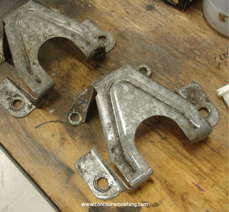

Thanks Jeff I will check page #33. I will try to see if I can find a photo photo of an original Calliper cover so I know what it should look like.
Here is a picture of one from a 69 example that I've posted in other threads

Thanks Jeff on both topics. Looks like the replacement Calliper cover is pretty close. So I take it that the main difference would be the part number and or Ford logo on the originals. I would also assume that just like the rotors originals may be out there from other Ford models using the same parts.

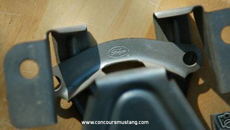

Aren't the replacement caliper covers the ones with the Ford trademark and assemblyline ones do not?

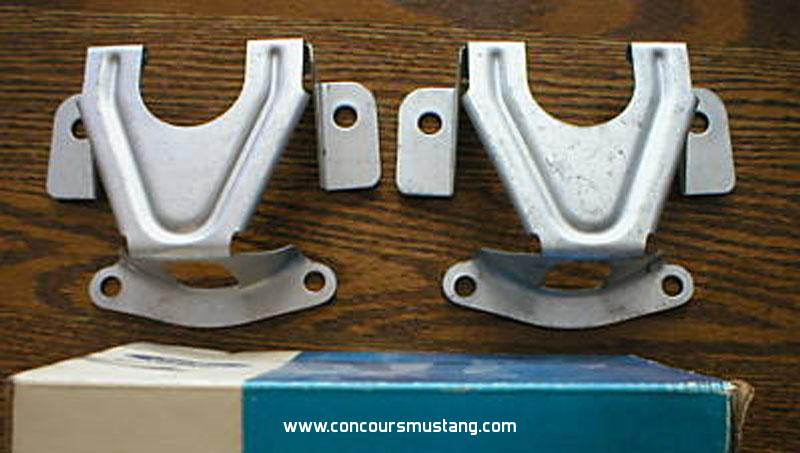

Believe this is the stamp Bob is referring to - Note that the picture is of one on top of another in reverse position so it makes the whole shot somewhat confusing
Don't have any service replacement pictures clear enough to make out the stamping as in the picture of D00Z-2C077-A shown below. Might be something on the one to the right - can't be certain for this pair as documentation

Thanks Jeff. So which parts have the Ford logo, the assembly line units or the NOS parts. Not sure if it is the photo or not, but the covers with the Ford stamp do not appear to be galvanized

Lacking any opposing information at this time I'm going with Bob on this one
So no markings and refinish them as looking galvanized would be my suggestion, what I've done in the recent past successfully
We may find that the marking was for later (than yours) cars or just as service replacements. More info will follow - just can't predict when
