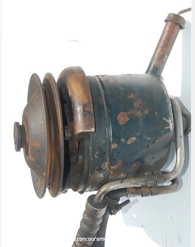

This pic applies:
The outlet was a curvy affair and paralleled the inlet on its way down.

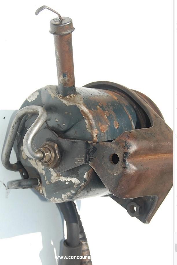

This pic applies:

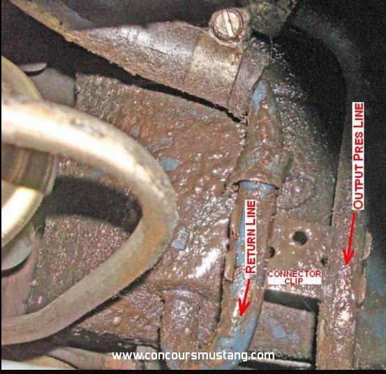

According to other pics I've found it doesn't look like a hose indexing bracket was required -- at the rear. Here is a pic of a dirty 70 351C Mustang as viewed under the car, straight up. The bottom of the fuel pump is to the left.
It appear that there is a tab welded to the inlet pipe and I'm guessing some sort of half circle bracket held the tube in place.

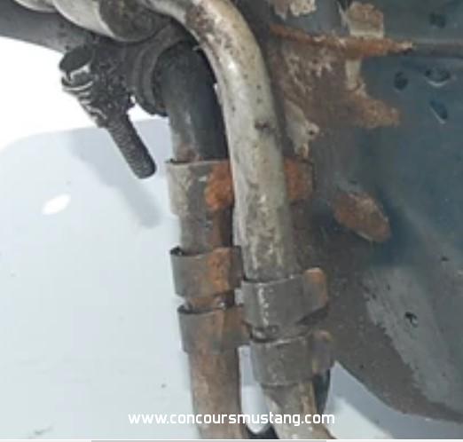

Another option is from this picture of the same area:
This is a closeup of my first pic and shows a double clip (like a 3) that holds the two tubes together. It's possible the double clip could fasten to the tab above or simply float.

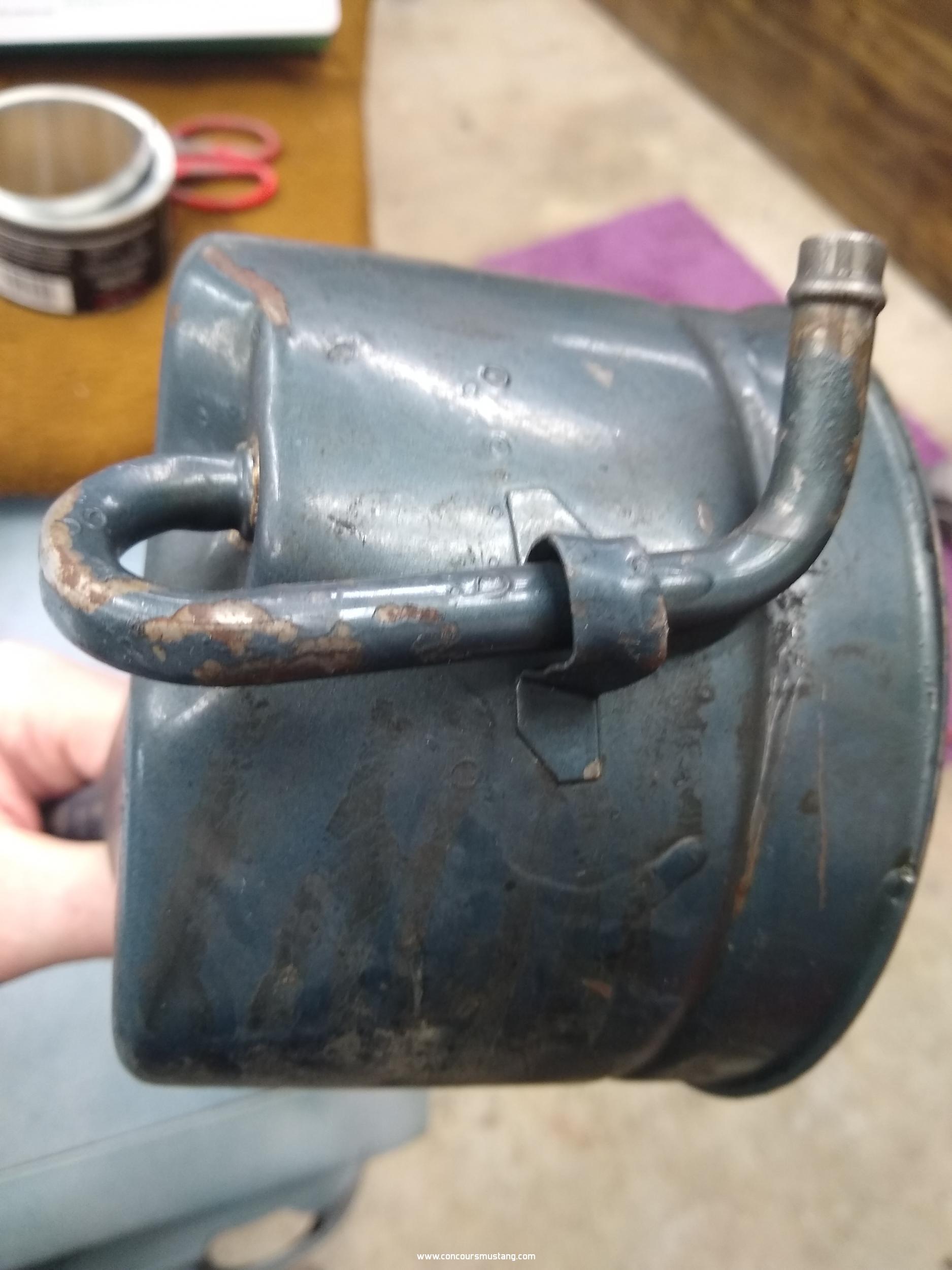

The can that I currently have is shown below:
There is a spot on the tube where a tab could have been, but that's uncertain.
