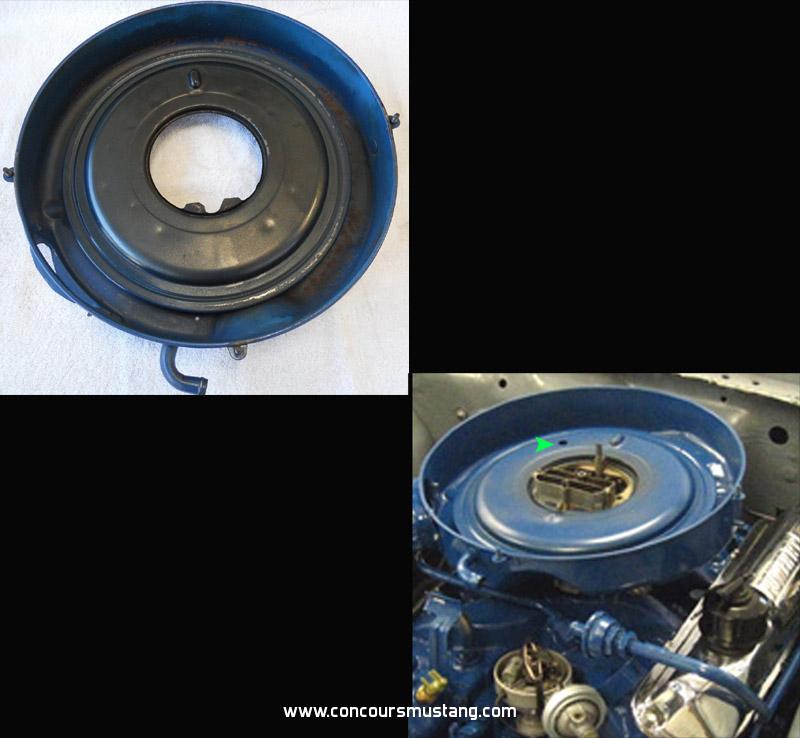

Any idea when this change happened on the 428CJ aircleaner base.

Guess (just confirming) your referring to the addition of the hole for the vent on the passenger rear area of the base. In an addition a metal tab was welded to the bottom to hold the attaching hose up out of the way.
If so documents suggest on or around mid Feb 1969 (17th date is listed) TSB info has often been more specific or correct IMHO than some other Ford publications though we could expect that different plants might be different by a day or two on some of these dates
428CJ site has some pictures posted over there.
https://www.428cobrajet.org/id-air-cleaner-69R
Early top left - Later bottom right

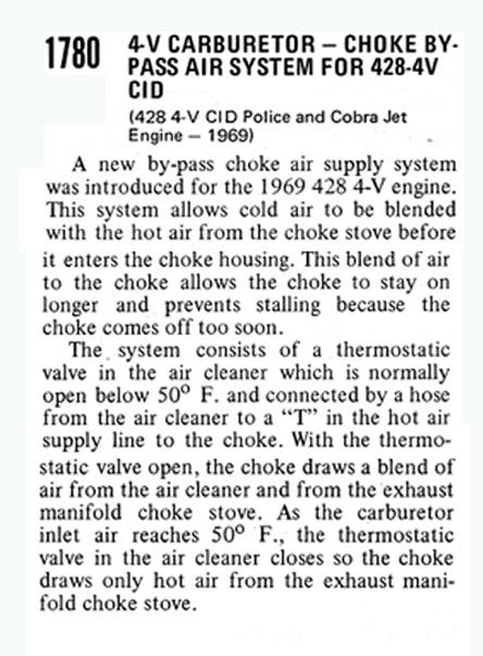

The text from the TSB Article that was published for the week of May 5th 1969

The text from the TSB that was published for the week of May 5th 1969
Jeff, it looks like we're both right in the way we described the TSB text (see attached). It's article number 1780 in TSB 114.
Thanks - corrected my earlier post. Over 30 years no one has noticed that. Guess, so that people can find these, they should be labeled by the TSB Article number
BTW where did you get that scan from? Its different in format from the TSB that I have, which is three columns full width of a 8 1/2 x 11 page. I cut and pasted to fit so I could post it here and still be fairly legible
